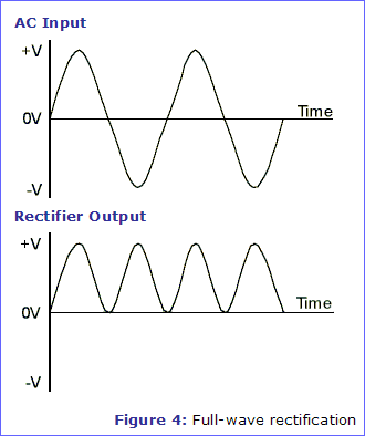

When you full-wave rectify a sine wave, you get a waveform that is 2x in frequency, plus the sub-harmonic at the fundamental, plus higher harmonics from the sharp-edged side of the waveform. If you feed that into another transformer and a filter at the 2x frequency, you can get pretty close to a 2x sine wave out. I've never done it, but it looks pretty plausible.
http://www.eleinmec.com/figures/018_04.gif
OK - I see what you mean- that would have a pretty ugly waveform, more humps than a sine, and if directly into a transformer it would saturate due to DC. Some capacitive coupling would take care of that but would be tough to transfer much power without big caps.

[STRIKE]Don't think it would saturate the transformer. There is an assymmetry to the waveform, but don't get fooled by the fact that we usually take the (floating) output of the first transformer and rectify the output and *then* reference it to ground. Just take the FWR output and put it straight into a 2nd transformer/filter...[/STRIKE]
After further thought, you are correct. The FWR makes the current always flow one direction through the primary of the 2nd transformer, so it would need to be sized to be able to handle twice the AC flux compared to if the input to the 2nd transformer were AC. Sorry for my mis-statement above.
