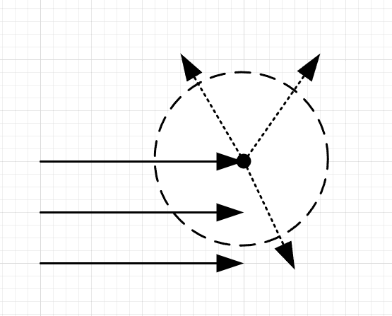

Let's assume a plane wave going in the x-direction. Going by Huygens' principle, each point on the wavefront should act like a source. If that's the case, wouldn't plane wavefront become spherical like shown below? I am so confused

Ok, I see, the wavefront touches "all" wavelets. I missed the word "all" before and that makes the difference in my understanding
Thanks.
