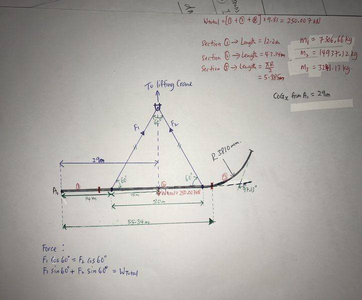

1. Homework Statement
I have problem solving the bending moment and shear force of a conduit with a curve end. The conduit is lifted in the mid-air with 2 slings and assume it is in equillibrum.
I have attach a drawing for reference.
What i know, there is a UDL somewhere and the forces y of F1 and F2 is = to the total weight of the whole conduit.Formula for moment at :Lecturer told me to use differentiation:
dMx/dx=0

I see your notations on the diagram. What do you get for the values of F1 and F2? What was your rationale in splitting the length into the specific sections 1, 2, and 3? From the geometry indicated on the diagram, what is the length of section 3? Do you need to determine the shear force and bending moment in section 3?

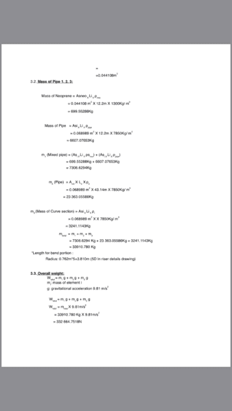

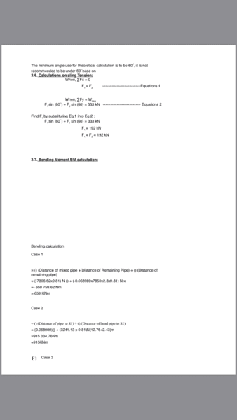

The values for F1&F2 =192064.1831Newton. The splitting of the pipe length is because the material and Shape is different. Length of section 3 = 5.985m. Yes i need to determine the whole BM & SF.
There is something wrong with your determination of the length of section 3. The subtended angle is 97.13 degrees, not 90 degrees. Also, the gravitational force is not perpendicular to section 3. The component normal to the pipe in section 3 is g cos (s/R), where s is the arc length along the pipe in section 3. This affects the shear force and moment calculation. How did you determine the center of mass (was this given to you)? Did you check to see if it is correct?
