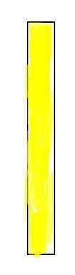

I need to find the final impact speed of the flame of a non-uniform candle. I am given that the mass per unit length increases linearly from top to bottom starting with 1kg/m at the bottom and 10kg/m at the top. I need to find how fast the candle flame is moving once the candle hits the table. I also know the length of the candle, 2m
Xcm=1/M∫xdm
m=Lλ
dm=dxλ
I=∫x2dm
If dm=dLλ then I have to find lamba ( which I'm unsure of how to do) then integrate from 0 to L to find the total mass. Then from there I can find the center of mass then rotational inertia and use energy to find the final velocity. Can someone tell me if I am thinking correctly and also help me find the total mass? Thanks in advance.

Well, a sketch of the value of density per unit length versus position would be helpful here.
Since you are given no other information besides the values of density at the top and bottom of the candle, along with the length of the candle, assume that there is a linear variation in the density of the candle per unit length.

Did you draw the picture yet?
Do you mean something like this? (But lighter at the bottom than the top)

No, I mean draw a graph which plots the value of the density of the candle along its length.
You know the length of the candle (2 meters; rather large, actually), and you know the density in mass per unit length at the top and bottom of the candle (10 kg/m and 1 kg/m, respectively).
In other words, make a graph of this information.

SteamKing wants you to draw a graph of ##\lambda## vs. ##x## so you can figure out an expression for ##\lambda(x)##.

Oh I understand now. I got a total mass of 22 kg. Is this correct?
Why don't you show your calculations?
