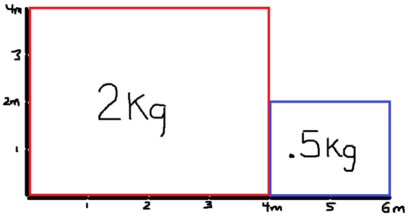

1. Find of the center of mass of the image below.

X = Ʃ(m1x1...) / Ʃ(m1...)
Y = Ʃ(m1y1...) / Ʃ(m1...)
Sorry I couldn't find a clear example. I have two different methods given to solve these problems, so I wouldlike clarification.
1. X = (2kg)(2m) + (.5kg)(5m) / (2kg + .5kg) = 2.6m
Y = (2kg)(2m) + (.5kg)(1m) / (2kg + .5kg) = 1.8m
So this one took the problems into point masses. Then solved for them.
X1= (2kg)(0m) + (2kg)(4m) / (2kg + 2kg) = 2m
Y1 = (2kg)(0m) + (2kg)(4m) / (2kg + 2kg) = 2m
X2 = (.5kg)(4m) + (.5kg)(6m) / (.5kg + .5kg) = 5m
Y2 = (.5kg)(0m) + (.5kg)(2m) / (.5kg + .5kg) = 1m
2. X = (8lb)(10m) + (20lb)(25m) + (20lb)(35m) / (8lb + 20lb + 20lb) = 26.6m
Why does it just use the lengths instead of combining them, or even taking the half-way point? Maybe I misinterpretted the problem? I assumed this at first.
X = (8lb)(5m) + (20lb)(17.5m) + (20lb)(52.5m) / (48lb) = 30m
But I guess those shapes can't be divided perfetcly in half. But why is it not
X = (8lb)(10m) + (20lb)(35m) + (20lb)(70m) / (48lb) = 45m
This clearly is too big to be logical.
Could someone explain this? Or link me to some CoM problems that aren't using point masses. I think thepoint masses are sort of self-explanatory, but I can't find good examples otherwise.
Thanks.
You get the centre of mass by multiplying the mass of a piece with the distance of the CM of that piece from a reference point. As nothing has been specified about the shape of the pieces you can asume that their CM is at the middle. If you measure the distance from the head-top of the human,
is correct, but it means the distance from the same reference point.
By the way, what unit is "m"?
meter, but clearly that was wrong. It was probably inches lol.
So the answer page that has the solution above should just be ignored? I mean it also seems like a plausible answer. The math just doesn't make sense.
Why is it 17.5 and nor 22.5 ??
You are right, it was a mistake. So X=(8lb)(5m) + (20lb)(22.5m) + (20lb)(52.5m) / (48lb) = 32m
ehild
Ok thanks. That math makes a lot more sense then the given answer.
