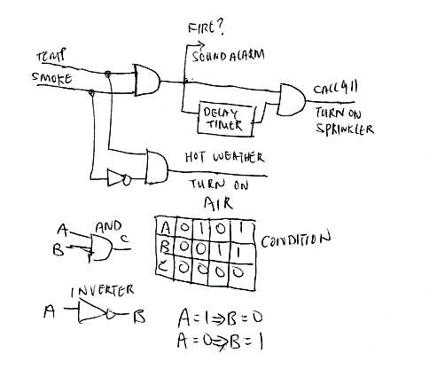

I am responding to OP's original post, I don't understand most of it even though I was an EE that studied hard on electromagnetics and all. Yes, binary is only 1 and 0, by if you have 2 bits, you can have combination of 00, 01, 10 and 11. with 4 bits, you have 16 combinations, 8 bits, you have 256 combinations and so on.
So this simple 1 and 0 quickly becomes very complex representing very complex sequence. Like simple ASCII code only use 8 bits, it can represent all the alphabets upper and lower cases and the other symbols of the keyboard. You can use more bits to represent even more complex codes. It all started out as 1 and 0.
It is hard to explain this until you actually study digital logic. That can show you how to take a bunch of 1 and 0s to create a very complex system. This is not even as obvious in computer languages unless you look into assemble language or machine language. But if you learn basic digital logic starting with AND, OR, NOT, XOR gates and build on it, you can quickly see this 1 and 0s grows into a very complex system very fast and complex decision making ability.
From reading your post, you seems to making it a lot more complicate by using very intimidating words and phrases. This is very very simple, using a lot of common sense. It starts out very simple and turn complex as you add more conditions ( bits).
say using over simplified example. You have a system that has two inputs, bit1 is 1 when temperature is high, bit2 is 1 when smoke is detected. So the decision making is if bit = 1, bit2 = 0, it's likely hot weather, turn the air condition on harder. If both bits are high, there might be a fire, turn on the alarm. Then set the timer, if both bits are still high after 5 minutes, call 911, turn on the sprinkler.
All these decision making only started with 2 bits of 1 and 0 and using a timer to time 5 minutes! It's just that simple, just a lot of common sense.
This is the logic design for the example:
You see, all the decision can be generated by only 3 AND gates and one INVERTER and one timer. I show you the TRUTH table what an AND gate and INVERTER do. It is just that simple. You can imagine if it doesn't take much more to make it a lot more complex.

One typo: The State Table should have a "1" in the lower right corner.
