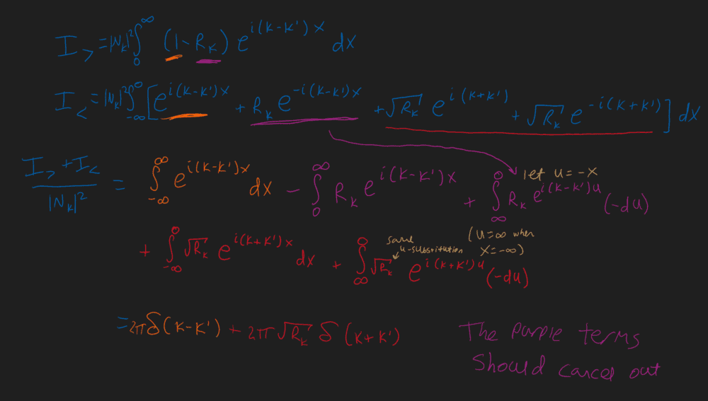

Here is my color-coded work. Just to expand on a few things: First, you should keep in mind that R is real and positive. Second, where I do the u-substitution, the negative sign can be used to swap the bounds of integration. Finally, when k'=-k, you get an interesting result as well. I think if you use your even-parity case, that problem will be sorted out. It shouldn't be surprising that scattering from the left is not orthogonal to scattering from the right with the same energy (although it would be if there is no reflection. This should make sense intuitively). The work I did here is still valid for k'=-k, as ##R_{-k}=R_k##.
Many thanks! But you can’t assume that ##R_k## is real. It is in general complex.
In fact, it is necessarily real and positive. The reflection coefficient is a probability. Theoretically, one can add a complex phase out in front of the square root, but that is arbitrary and should not affect the calculations at all.
