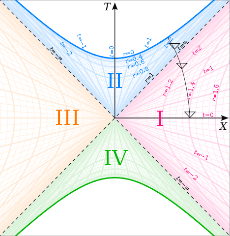

I am trying to project a black and white hole onto a field of Schwarzschild spacetime and I don't know what to do. Do you have any advice?
Your question still doesn't make sense. Again, where are you getting this from? What makes you think this is even a meaningful thing to do? Why do you want to do it? A reference would be helpful.
Likes robphy
Schwarzschild spacetime is a black hole and a white hole. Your question makes no sense.
Are you trying to find the spacetime for a binary blackhole? You can't do it by adding together two copies of the solutions for one black hole.
Likes Dale
The maximally extended Schwarzschild is both a black hole and a white hole. If you are just trying to visualize that, my preference is Kruskal coordinates
