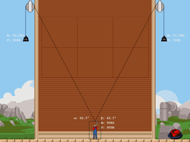

I have 3 masses with 2 pulleys which is in static equilibrium.
M1 & M3= 50.8kg
M2 = 90kg
Gravity that I used = 10m/s²
Part 1
Prove that the system is in static equillibrium
Part 2
If I were to add another 10kg of mass to M3 is the force exerted from M3 the same force as the tension from the rope. Assuming the pulley and rope is massless?
And how do I find the displacement of all the masses (M1, M2, M3)?
Will the system be in an equilibrium or not?
If it's not, show how do you find the acceleration, velocity and displacement for all three masses.
F = ma
For part 1, from the equation I have drawn a FBD for M2 and have calculated the net forces of F(x) and F(y) for M2 which is:
Fx = 508 * cos (62.5) - 508 * cos (62.5) = 0;
Fy = (508 * sin (62.5) + 508 * sin (62.5)) - 900 = 0 (I round it off due to calculation approximation);
Am I doing the part 1 correctly? As I am assuming that the forces from M1 & M3) is acting on M2 so I took the forces from there and apply it on the FBD for M2.
For part 2, I can't really continue if I'm not sure whether part 1 is right (correct me if I'm wrong whether can I still continue on part 2). Even then, I'm trying to find the relationship between F = ma and the a, v, and s(displacement) cause I have been searching for the equation but I seem to be more lost than ever.
Thanks once again and I hope I don't sound too dumb as I am new to statics.

Part 1 seems to be correct.
For part 2: Think about what is the necessary condition for a second equilibrium after increasing the mass M3 (hint: the angles α and β will be different then).
For part 2, the necessary condition for an equilibrium on the system is that all net forces must equal to 0, however, when I calculated after adding 10kg on M3, wouldn't the Fx and Fy for M2 also changes (correct me if I'm wrong), which means M2 will travel along the rope of M3, which will pull M1 up, resulting in an infinite acceleration thus can't be in an equilibrium? So sorry if I sound dumb or stupid, am really new at this and have been self taught from youtube tutorials and etc.

I can only imagine that the affected mass (M3) will go down, thus M2 will go north east due to the resultant force applied from M3, which then M1 will have to move up to accommodate to the movement of M2.
Here's what I got so far:
Fx = 608 * cos (62.5) - 508 * cos (62.5) = 234.6 (rounded up);
Fy = (608 * sin (62.5) + 508 * sin (62.5)) - 900 = 89.9 (I round it off due to calculation approximation);
Thus, the Resultant force is: R = √Fx2 + Fy2 = 251.2;
and the resultant angle is: Rangle = arctan(89.9 / 234.6) = 21;
I'm not sure whether I'm doing it correctly but then again, after finding this, is the system at equilibrium when the mass with 90kg moves over to its new position?

Yes. α and β both change. You need to find the new α and β. You do this by writing the force balances in the x and y directions in terms of α and β (algebraically), and solving for the new α and β.

No, the new unbalanced force will cause a finite acceleration. First, calculate the new equilibrium angles (at least show the equations; solving them is tricky).
So it will be something like,
Fx = 608 * cos (α) - 508 * cos (β) = 0;
Fy = (608 * sin (α) + 508 * sin (β)) - 900 = 0
I then used algebra to solve for Fx and got
(α) = cos-1(508 cos (β) / 608) = cos-1(0.84 cos (β)
This part I am stuck as it got a little tricky honestly.
does cos-1 cancel out cos (β)?

Yes apologies it is supposed to be
Fx = 508 * cos (α) - 608 * cos (β) = 0;
Fy = (508 * sin (α) + 608 * sin (β)) - 900 = 0
(α) = cos-1(608 cos (β) / 508) = cos-1(1.2 cos (β))
replace (a) to Fy's equation I get:
508 * sin(cos-1(1.2 cos (β))) + 608 * sin (β)) - 900 = 0;
508 * sin(cos-1(1.2 cos (β))) + 608 * sin (β)) = 900;
I wanted to factorise but it doesn't seem that there's any common values.
Anyway,
@azizlwl cosine law? as far as I can remember I think need to know the three sides which is currently unknown at the moment, no?
$$\cosα=\frac{508}{608}\cosβ$$
$$\sinα=\sqrt{1-\left(\frac{508}{608}\right)^2\cos^2β}=\sqrt{1-\left(\frac{508}{608}\right)^2+\left(\frac{508}{608}\right)^2\sin^2β}$$
Substitution in Fy equation yields:
$$\sqrt{608^2-508^2+508^2\sin^2β}+508\sinβ=900\tag{1}$$If we multiply numerator and denominator of the left hand side of this equation by##\sqrt{608^2-508^2+508^2\sin^2β}-508\sinβ##, we obtain:
$$\frac{608^2-508^2}{\sqrt{608^2-508^2+508^2\sin^2β}-508\sinβ}=900\tag{2}$$
If we invert Eqn. 2, we obtain:
$$\sqrt{608^2-508^2+508^2\sin^2β}-508\sinβ=124\tag{3}$$
If we subtract Eqn. 3 from Eqn. 1, we obtain:
$$1016\sinβ=776$$or$$\sinβ=\frac{776}{1016}$$So, β=49.8 degrees

Thank you! Took me a whole day to understand how did you obtain those values and I think I got the accurate answers using different masses on M3. So the new position of the M2 is determined from the new tensions from M3, am I right?

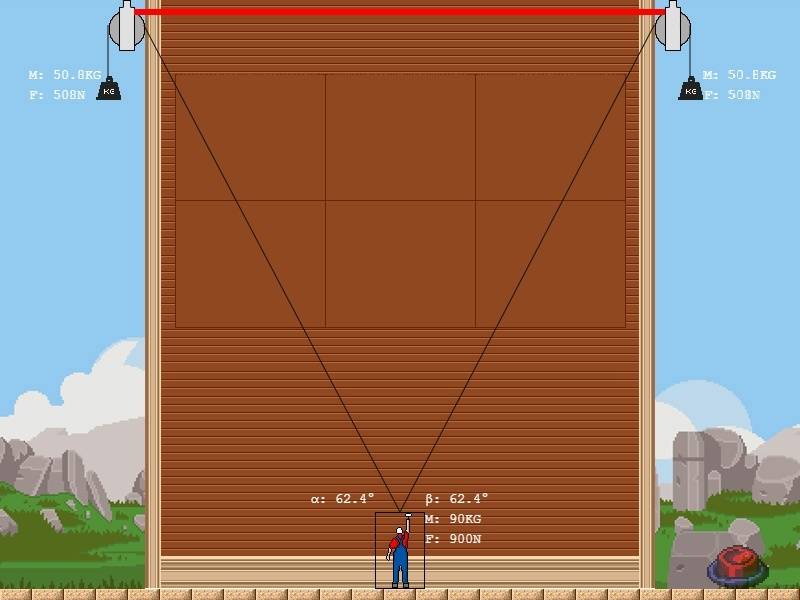

No. You need to know the distance between the pulleys (or some characteristic distance).
The distance between pulleys meaning, the red line? (See picture for reference). If I were to have the values, can I assume that I will be able to solve using basic trigonometric formulas seeing that I have the angles needed? (TOA CAH SOH).
Yes.
