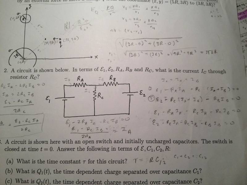

http://imageshack.us/a/img585/9687/kvlf.jpg
the work i did on that sheet is completely wrong.
I know that Ic = Ia + Ib
but can someone help me set up the equations for the two loops please! I can't seem to figure it out and its frustrating me!

Write the KVL equation for the "left loop".
Write the KVL equation for the "right loop".
Write the KCL equation for either junction.

thanks i just figured it out. this is just an intense algebra problem!
Yes. Algebra is involved.
