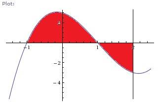

Next, let's sketch the area to be found:
Do you see now that the area under the $x$-axis will require us to integrate the negative of $f(x)$ on that interval?
When we are computing the area between two curves (and this is what we are doing if we observe that the $x$-axis is $y=0$), then we need to use as our integrand the magnitude of the difference between the two curves:
\(\displaystyle A=\int_a^b \left|f(x)-g(x) \right|\,dx\)
So, we need to know on what intervals $f(x)>g(x)$, since by definition:
\(\displaystyle |u|=u\) when $0\le u$ and $|u|=-u$ when $u<0$.
So, we see that on $(-1,1)$ we have $0<f(x)$ and on $(1,2)$ we have $f(x)<0$, hence the area can be found with:
\(\displaystyle A=\int_{-1}^2\left|f(x)-0 \right|\,dx=\int_{-1}^2\left|f(x) \right|\,dx=\int_{-1}^1 f(x)\,dx+\int_1^2 -f(x)\,dx=\int_{-1}^1 f(x)\,dx-\int_1^2 f(x)\,dx\)

Re: area using integration
thanks mark. but I'm still struggling to understand the entirety of your answer. how did you know the graph of that function. did you just punch it in a graphing calculator? i want to know how to draw that without using graphing calculator. what do you mean by "the sign of f(x) will alternate across the roots? thanks!
While I did use a graphing utility to obtain the plot of the function, it was not necessary, only easier to use to generate an image I could then attach. We really only need to know the sign of the function, so we know on which interval(s) to use the function itself as the integrand and on which interval(s) to use the negative of the function as the integrand.
why do we need to know the intervals which the function is positive and negative?
Because on those intervals in which the function is negative, integrating will return a negative value. so we need to negate the function on those intervals to return a positive value. If we simply integrate the given function over the entire interval, then we will get the area above the $x$-axis minus the area below. But, we want to add the two areas to get the total area.
