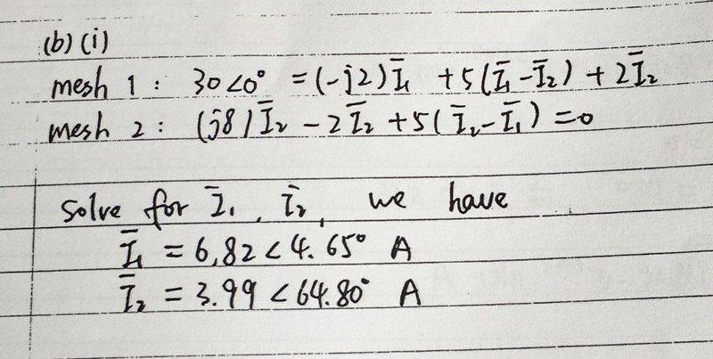

I'm having trouble figuring out to get the answers from the 2 equations. The phasors and complex numbers confuse me. Do I need to change the phasor form? How do I go about doing this thanks! (Not homework question I am trying to figure this for my exam!)

There are lots of ways to do this sort of problem ...
For complicated meshes, you may find it easier to convert to complex impedences and use a+jb type notation.
So 20∠0 would be just 20+0j, 20∠π/2 would be 0+20j (j=√-1). Then you can solve the simultaneous equations normally.
For simple problems you can usually just add the phasors like vectors.
Likes whatphysics
Rearrange your equations so that coefficients of I1 and I2 are together like this:
(5-j2)*I1 + (-3)*I2 = 30
(-5)*I1 + (3+j8)*I2 = 0
Now you can use a standard method to solve them but with complex arithmetic: http://www.mathportal.org/calculators/system-of-equations-solver/system-2x2.php
Will your exam be a take home? If so, you can find solvers on the internet to do the job; search for "simultaneous complex linear equations calculator". If you will be solving systems like this at school, you should get an app for your laptop or get a calculator that can solve simultaneous complex equations.
Likes whatphysics
No unfortunately it isn't a take home exam, I have a Texas instrument Graphic Calculator but I don't think it can solve complex simultaneous equations.
But thanks for the great help!
What model is your TI calculator?
TI-84 Plus Pocket SE
It might be worth your while to get a calculator that can do complex arithmetic. The TI-86 can do complex arithmetic, including matrices with complex arithmetic.
I see them for sale on eBay from $20 to $35.
Likes CalcNerd
I, usually, use the excel complex system.
However, at first you have to rearrange the equation as The Electrician said.
a*I1+b*I2=V1 where a=5-j2; b=-3+j0 ;c=-5+j0; d=3+j8; V1=30+j0; V2=0
c*I1+d*I2=V2
1) define a,b,c,d,V1,V2
2) put a=COMPLEX(Re,Im) where Re=5 and Im=-2 in your case.
Do the same with b,c, d,V1 and V2.
3) define DetGen and put IMSUB(IMPRODUCT(a,d),IMPRODUCT(b,c))
4) define DetI1 and set IMSUB(IMPRODUCT(V1,d),IMPRODUCT(V2,b))
5) define DetI2 and put IMSUB(IMPRODUCT(V2,a),IMPRODUCT(V1,c))
6) I1=IMDIV(DetI1,DetGen); I2=IMDIV(DetI2,DetGen)
