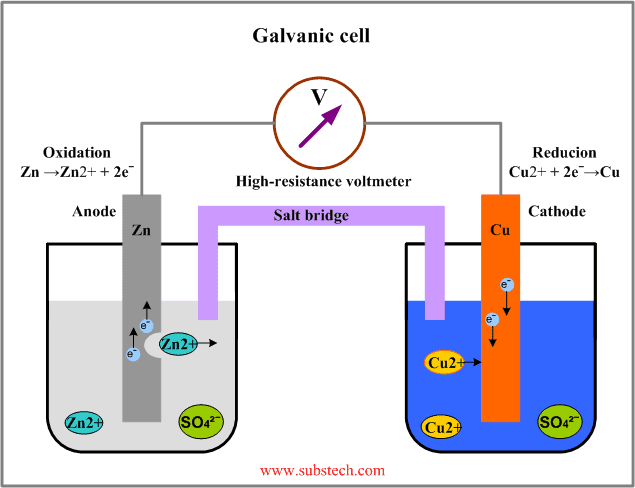

Again, I understand this in a general way, but not how this way of thinking relates to the microscopic or electrochemical perspective. If we now consider the battery in the circuit in the clip (link above) as a galvanic element of zink and copper:
Where does this "lifting" within the battery enter the picture? According to the explanation above it is as if the battery lifts charge from a side with low potential energy (which I assume is the equivalent of the cathode) to a place with high potential energy (anode), but in a galvanic element the charge flows just one way from the anode to the cathode. I understand how a galvanic element pushes charge from a place of high potential energy to a place with low potential energy, but not the other way around. If charge is to flow the other way an electrolysis must be performed, in which the battery is charged. But according tot he explanation above it is as if the battery, when it works as a basic galvanic element, lifts charge from a place with low potential energy to a place with high potential energy by pushing it against the electric field, without performing an electrolysis. This I do not understand, and I would like an explanation.

Copper "prefers" to be in the reduced state, zinc "prefers" to be oxidized. So copper attaches to the electrode and steal electrons from there, while zinc jumps into the solution getting rid of electrons - that means one electrode becomes charged positively, the other negatively - and you have a potential difference.
