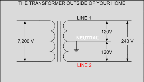

hello everyone,
1:- in the below video i think the transformer used is called centre tap transformer. someone was telling me that the input voltage of 12V is divided between two voltages of 6V across the secondary coils. But at one time only one secondary coil is really conduction because the other one would one wouldn't be able to conduct because the diode is reverse biased.
hence i think at one time entire 12V appear across a single secondary coil instead of 6V.

Sorry, but no.
At any time the Voltage across S1 and S2 are 6 V each, irrespective of whether you connect the bulb or not.
The voltage induced in S1 and S2 are determined by no. of turns in them and in p1 and p2.
Also, your figure depicts two primaries. This is ok if they are wound on a single core but you did not draw the core. As it is, the figure depicts two separate transformers connected in series. It's not the same thing as a center-tapped transformer (unless you draw the core spanning all the coils.)

Your diagram is a little inaccurate, physically speaking. This is the proper symbol for a CT transformer:
There is one primary winding, and one secondary winding, and a wire attached in the exact center of the secondary, which is why it's called center tapped
There are 6 volts across the bottom half of the secondary, whether or not the switch is closed. There will ALWAYS be 6 volts, no matter how much current is drawn from it or the other half of the secondary (assuming ideal transformer and no change in primary voltage). Likewise, there will always be 6 voltage across the top half, regardless of how much current is being drawn from either half.
Just because there is no current doesn't mean that there isn't a voltage.
You need to start from basic transformer theory. What you are thinking (that the circuit needs to be closed for voltage to induce and the theory that inducing require investment of energy which is provided by... etc etc) is WRONG. Re-read the theories again. You need to understand simple transformer first before you understand center taps. Center-taps are not such a different thing, knowing the simple transformers automaticallly answers the question.
Hello once again everyone, :wink:
Just a small question I hope you would not mind its asking.
I will use Jiggy-Ninja's diagram for my question. As the CTT splits the voltage into 120V around the two secondaries, so I was thinking if it is possible to get some 240V some way. I think this is not possible. By combining the voltage one can get 'overall' increased current as is the case with combining two batteries in parallel.
Have a see here on this link please:-
http://img97.imageshack.us/img97/9539/ctt1.jpg
"B" in the diagram is a bulb and both batteries of 120V connected in parallel.
Is my understanding correct?:rolleyes: Tell me please.
Cheers
Connect line 1 to ground / Earth and you have 240V AC. No problem. 120 +120 = 240
Many thanks sophiecentaur. :approve:
