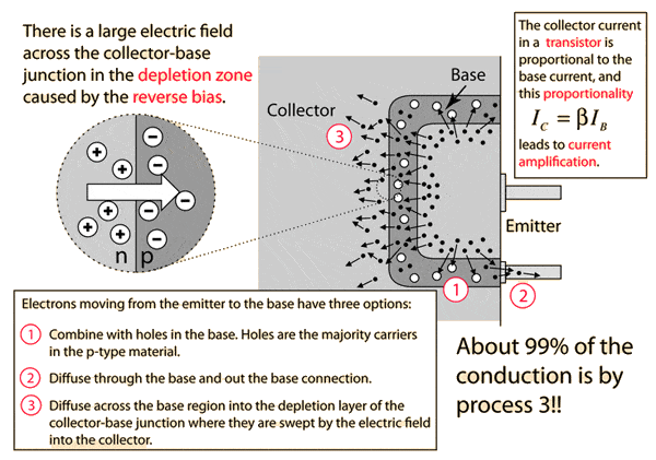

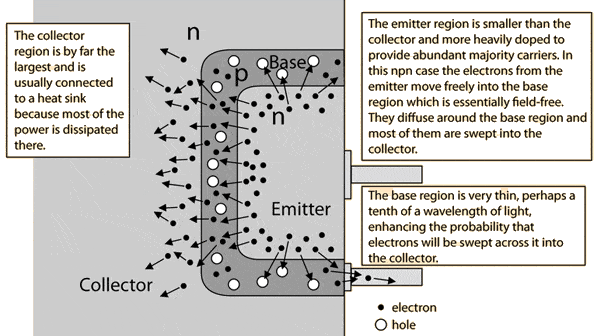

Bararontok said:
What electromagnetic processes in the semiconductor material ...
The 7400 series of integrated circuit logic uses Transistor–transistor logic (TTL) built with bipolar junction transistors. So understanding how transistors operate is where to start. Here's a couple images that may be a start for what you are looking for:
From http://hyperphysics.phy-astr.gsu.edu/hbase/solids/trans2.html
Here's their index of Semiconductor Physics for Solid State Electronics.
