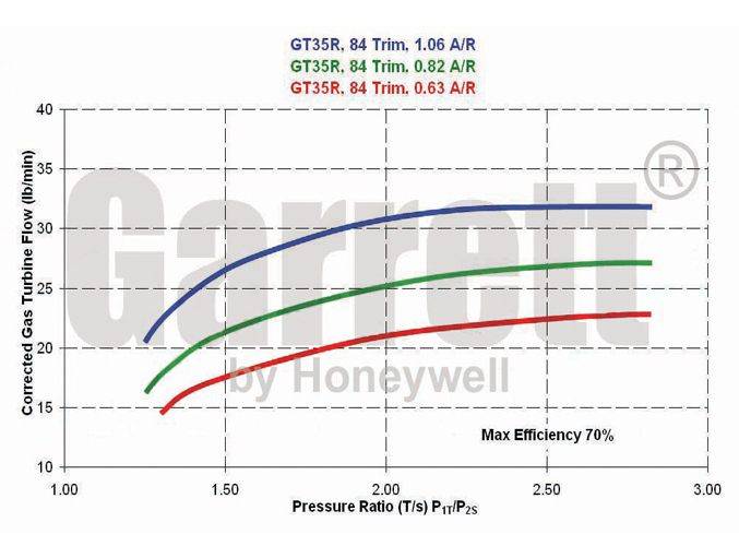

They also include graphs of pressure ratio across the turbine for each model of turbocharger such as this one for the GT35R with 3 different trims:
I read this to say that the absolute pressure ratio of aproximately 2.5 gives the best isentropic efficiency at around 70%, so if the outlet pressure of the turbocharger is 15 psia, the inlet pressure is 37.5 psia (or 2.5 times higher than outlet).
