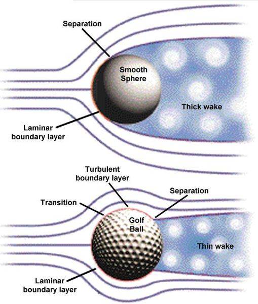

Does air flow along a surface with a lower coefficient of friction more easily or does it not make a difference?
In this case, the terminology you are looking for is not COF, but surface roughness. COF implies two surfaces/objects in contact. Surface roughness simply is a statement of the average variation of a surface. In the case of airflow, a smoother surface definitely helps. Look at any aircraft wing. The rivets are as flush as possible and are kept very clean.

That's a good question: strictly speaking, air (or any fluid) in contact with a solid surface moves at the speed of the surface; the phrase 'air flow along a surface' usually refers to the boundary layer, the thickness of which is arbitrarily defined. The connection between the boundary layer flow and macroscopic (far-field) flow can be quite complex.
Surface coatings, as Fred mentioned, are used to affect the boundary layer in order to create a particular "far-field" flow pattern; microroughness treatments are a characteristic type of treatment which, IIRC (I'm not an expert), thin the boundary layer, move the separation point downstream, and restrict far-field turbulent wakes. This reduces drag.
In the case of gliders, the wing surfaces are sometimes "roughed" up a bit with fine (600) grit sandpaper to better control the transition from laminar to turbulent flow that "detaches" from the wind during the transition. Do a web search for "glider oil flow test" to see example of this.

Jeff. I was shooting the breeze with an aeronautical engineer this afternoon and this very topic came up. The dimples promote a turbulent boundary layer that stays attached to the surface further along the profile of the ball than a laminar flow. This reduces the size of the turbulent wake--a little cone shaped region at the leeward side of the ball. This is a low pressure region that slows the ball in flight. So, with less wake, the ball flies further.
Interestingly the turbulent boundary layer has greater surface drag than laminar flow, but this is more than offset by the reduction in wake size, be it a golf ball or a wing.
That is absolutely correct. It forces a turbulent BL and the reduction in wake is very dramatic.
That is quite a difference. Now if they could just put the dimples on the leading edge of the spinning ball, and leave the rest nice and smooth... :rolleyes:

Hmm. I wasn't completely correct, apparently. I'd thought that the cross-section of wake reduced in size and eventually closed-off--a cone shape. But the turbulence in the wake doesn't just disappear, but diminishes in amplitude over time.
