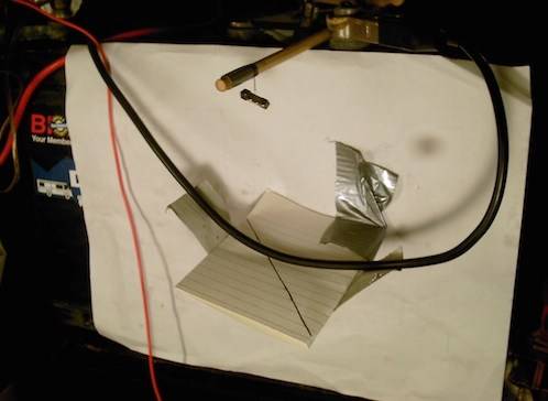

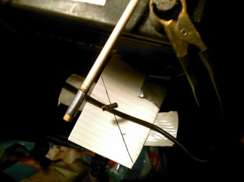

In the interest of science, I just built one, based on Jim Hardy's comments.
I'm still not sure how exactly it works, as the data seems a bit scattered.
Here's my setup:
One current carrying conductor, aligned with the Earth's magnetic field
A set of 4 neodymium magnets, self-clamped onto the end of a thread, suspended from a stick
One 4 x 6 inch card, with blue lines aligned with the Earth's magnetic field, and a black line drawn in, at 45°
And duct tape, of course.
Discharging:
Charging:
data:
distance: measured with a nonmetallic caliper
amps: measured with a digital multimeter
gauss: derived, from adding everything together(might be wrong)
dist(m)__amps____gauss
0.11_____6.1_____0.11
0.028____3.1_____0.22
0.016____2.7_____0.34
Given, that there are 3 magnetic fields: one circular(conductor), one linear(earth's), and one, somewhat in-between(magnets!), I can only state that I was very happy to be not off by an order of magnitude.

OM now that is Neat !
I see your magnet rotated...
My antique ammeter is very handy for qualitative measurements under the car hood (Bonnet?).

Neater still, is after my nap, I went back and looked at my setup, and decided I wasn't qualified to tie my own shoes.
I'd started the experiment at the lower amperages, and decided that the distances were so close, that I didn't have to worry about stray magnetic fields. Unfortunately, that stuck in my head, as the distances got really big. Big mistake:
The big black conductor made a fairly decent half loop, so my equation for the magnetic field generated by a straight wire was invalid.
I just redid the experiment. The results were much better.
0.058____9.5_____0.33
0.037____6.1_____0.27
0.023____3.3_____0.29
0.008____1.7_____0.43
Of course, you can't get rid of stray fields, but you can estimate them:
0.300____9.5_____0.06
0.600____9.5_____0.03
Tomorrow, I will cut up some tuna fish cans, and see if I can't contain some of the fields.
SCIENCE!

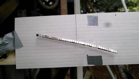

ps. I'm still trying to figure out why, when I'm told that the Earth's flux is ≈0.54 gauss where I live, I come up with a smaller number. And why do the Earth's magnetic field lines have a negative slope where I live?
And should I modify the experiment to compensate for that?
pps. The image was taken with a perfectly level level. I was the one askew.
ppps. Borek was correct. There is dirt on my lens.
Earths field can be effected by local anomalies. Here's NOAAs Geomagnetic Calculators.
Because you don't live on the equator? Which way is north in your pic?
To the right.
How can you be sure you have that assemblage balanced at its CoG?

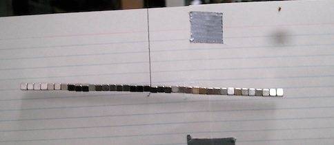

Balanced at the center of gravity? Obviously it isn't/wasn't.* The string was vertically supporting the magnets, so the fulcrum was at the top. (another reason why people should be tying my shoes)
I gave up after 30 minutes of trying to balance the magnets @ 67.5° with a horizontal supporting string. Buckycubes are only 4mm on the side, and eyeballing such things, at my age, are, well, fruitless.

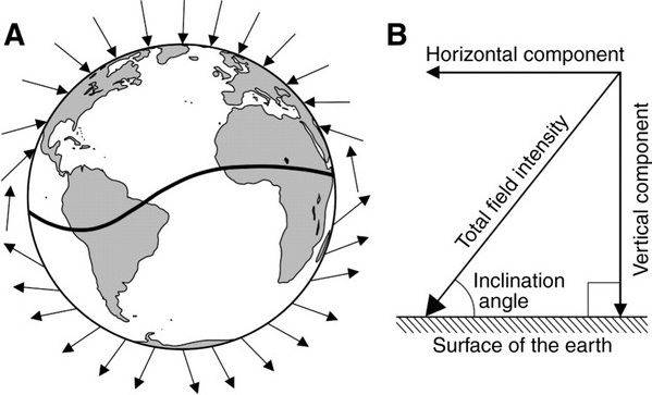

As for the tilt of the magnetic field:
I'm sure I'd seen the images before, but it never really sank in.
* I thought of that also. So I swapped the magnets. It only made things worse:
After a lifetime of looking at compasses pointing north, it was quite the shock to see that north was 2 feet in front of me.

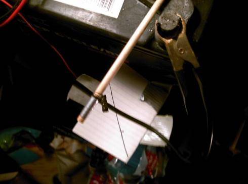

hmmmm... I rebuilt my ammeter, and discovered that I don't know how to balance the system.
How on Earth did those people in the olden days figure this out!

I wonder how relevant the Earth's magnetic field is, to this when you have a massive iron yoke around the wire and a gap with the compass in it. I have a feeling that what's needed is a small (compass style) magnet which will fit inside the gap - sprung to lie parallel with the flat ends of iron U. For the best calibration, the magnet must be small and to fit well within the local magnetic circuit. The field due to the current in the wire will be around the yoke and will cause the magnet to deflect against the spring according to the sense and amplitude of the current. I have a feeling that the reluctance path across the gap will be so much higher than the path through the 'back' of the yoke that the Earth's field will have little effect on the magnet itself.
I think it's a sort of common mode / differential mode thing, with the Earth's field only affecting the differential mode.
I just redid the experiment, with the conductor vertical, and came up with the following:
0.006____1.7_____0.57
0.014____3.4_____0.49
0.036____6.1_____0.34
0.051____8.3_____0.33
At least I'm getting closer. The vertical component, per Don's computer, should be 0.49 gauss.
I'm calling this, close enough for government work.
