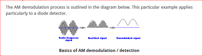

from http://www.radio-electronics.com/in...plitude-modulation-detection-demodulation.php
Left waveform is an AM radio signal. It is a high frequency AC wave, usually sinusoidal , and of the Radio station's Frequency . It's called RF for short.. actually "RF carrier" because it "carries" the lower frequency information that is to be conveyed.
It is "amplitude modulated" meaning its amplitude shrinks and swells as shown, at the much lower rate of the information it's carrying maybe voice, music or data.. That one looks rather like it's modulated with a sine wave, maybe it's a pure note from a violin or Madonna's pretty voice singing something.
The tips of the RF wave form the "Envelope" so called because when you look at it with an oscilloscope the individual RF waves are packed so close together they just look like a solid mass , ie they are 'enveloped'(surrounded) by the modulating signal.
" Demodulation" at its simplest is a two step process, Rectify and filter.
"Rectify" means chop off and discard half of it , in this case we've removed everything below zero volts, the negative half, leaving just the positive half of the RF wave. A simple diode will rectify the RF .
That leaves you with the middle signal. Usually the rectification process is called "Detection" and the rectifier is called a "Detector" because there are other methods of demodulation. This one is the simplest and has been around for a hundred years.
Filling in the gaps between the rectified RF peaks completes the demodulation. A simple capacitor that's not too big will accomplish this. It is sized large enough to hold charge between the RF peaks but not large enough to hold charge between the slower peaks of the envelope.
That capacitor connects the RF peaks just like connecting dots, leaving you with just the envelope frequency.
So the RF has been "filtered out" , completing the demodulation.
You're left with the third waveform.

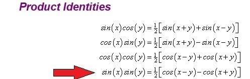

Addition and multiplication of sinewaves don't give the same result.
Addition just gives sin(a) + sin(b), the original frequencies.
multiplication gives
and observe taking the product gives you two new frequencies, sum and difference of the originals.
Those are called the "sidebands" because they are centered on the mean and differ by twice the modulating frequency.
That mean is the carrier, sum and difference are the sidebands. They sum to that enveloped wave in post #5.

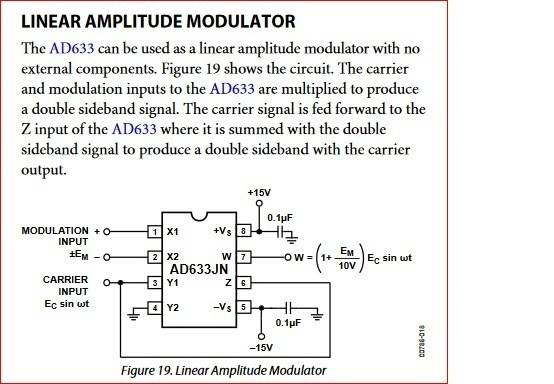

When you want to Amplitude Modulate a sinewave, you multiply it by another one.
That's not too difficult with tubes or transistors
but nowadays everybody uses specialized integrated circuits
(well radio stations probably still use giant tubes, maybe our Ham radio friends on PF will elucidate)
from http://www.analog.com/media/en/technical-documentation/data-sheets/AD633.pdf
Note the multiplier gives just the sidebands, in agreement with the trig identity up above for products, and they add the carrier back in at pin 6. That's why i like electonics , it is so close to math.

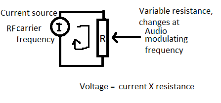

How a real analog multiplier works
It is easy to make a controlled current source using transistors
and it is easy to make another transistor behave like an adjustable resistor
so place them in series and by ohm's law and you have multiplied .
that's called a "transconductance " multiplier.
There are other types.

musichascolors said:
Pitch is incorrect, tremolo and vibrato are often used interchangeably but they're not the same thing. Pitch(vibrato) would be frequency modulation and volume (tremolo) would be amplitude modulation. That's why I thought it would be applicable(?)
in that case you have it right.

Playing around with my synthesizer, I am able to see the sidebands develop as I increase the rate of modulation (up to a point)
The only clumsy part is I'm having to do it with a triangle wave, which is the closest I can get to a Sin.
But I can still see the sidebands develop around the fundamental of the triangle.
I know sometimes speakers/amps will pick up a radio signal. I'm confused as to how the signal is demodulated accidentally. Are the signals picked up exclusively AM, or do FM signals get picked up as well?
As a matter of interest there are two main ways that an amplifier device (such as a transistor or vacuum tube) can cause rectification and demodulation of an AM signal. Assuming a bipolar transistor:-
1) The usual input connection between base and emitter is a diode, and unless the characteristic is swamped out with a high resistance, it will rectify. For a tube, this rectification is used for the "leaky grid detector".
2) The input/output characteristic (the mutual characteristic) is usually curved towards the upper and lower ends, as overload is approached. If the bias sets the device near a curved part, then we have "collector bend" or "anode bend" rectification.
So this seems to be an interesting demo
I converted into mp3 and then ran it through a software program that rectified it. Then I lowpassed it so frequencies above 500 hz were removed (the carrier frequency is 558)
It did indeed sound smoother.
But why does the rectification lower the distortion?
Not sure what you have done, but the carrier needs to be twice as high as the maximum audio, otherwise the sidebands and audio get mixed up together.
  • #31
Sorry, here's the demo
"I converted into mp3 and then ran it through a software program that rectified it. Then I lowpassed it so frequencies above 500 hz were removed (the carrier frequency is 558)"
Ok so i'll do another low pass at 225 hz (or 200 to be safe)
there won't be much audio in that case but yeah.
Also your comment is really helpful, thanks!
  • #32
That doesn't look rectified...
  • #33
Well I don't think it's rectified in the audio example
  • #34
