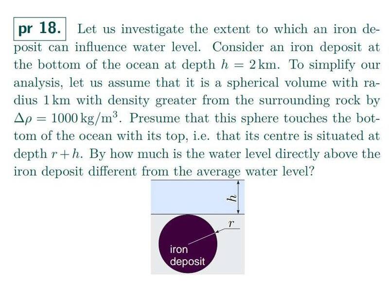

Let us investigate the extent to which an iron deposit can influence water level. Consider an iron deposit at
the bottom of the ocean at depth h = 2 km. To simplify our
analysis, let us assume that it is a spherical volume with radius 1 km with density greater from the surrounding rock by
∆ρ = 1000 kg/m3
. Presume that this sphere touches the bottom of the ocean with its top, i.e. that its centre is situated at
depth r +h. By how much is the water level directly above the
iron deposit different from the average water level?
$$U=mgh$$
what i understand i have to do is find the formula for the potential energy with this iron deposit and substract it from the potential energy before this iron deposit was placed there. I found the solution but i do not undsrstand why the formula for potential gravitation energy was used.
what i did was $U=($\rho$ $\pi$ g r^3 \frac{4}{3} )( \frac{1}{h} - \frac{1}{(h+r)})$

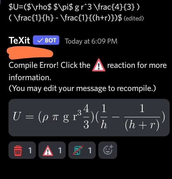

hmmm i dont know why it doesnt work here i tried to write it on discord using LaTex

what i did was $$U=(\rho\pi g r^3 \frac{4}{3} )( \frac{1}{h} - \frac{1}{(h+r)})$$
You needed to double up the dollar signs at the ends and remove the embedded ones.

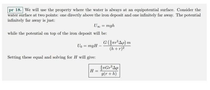

does the solution provided in the pdf make more sense?
Yes, except that there seems to be a confusion as to whether H is the extra height (as in the final boxed equation) or the total height, including h, as in the preceding equation.
To be clearer, I would replace H in the boxed equation with ##\Delta h##.
Edit: I inadvertently squared all the distance denominators as though the expression was for force, not work. Corrected below:
Here's the reasoning:
The presence of the iron blob creates a loss of GPE at height h. The extent of that loss is ##\frac {GMm}{h+r}## where M is the extra mass of the blob (compared to the rock it replaces). To offset that, we go up to height ##h+\Delta h##, so by ##\Delta h##. Roughly, that adds ##mg\Delta h## to the GPE. That gives the equation in the solution.
I suppose, strictly speaking, we should also consider how the iron blob affects that. I.e. it really adds ##mg\Delta h+GMm(\frac {1}{h+r}-\frac {1}{h+\Delta h+r})##, so the equation becomes ##mg\Delta h=GMm(\frac {1}{h+\Delta h+r})##, but that gives you a cubic to solve.
I have a different perspective on this. The amount of work required to move a test mass m from radial position r of a sphere to infinite radial position is $$W(r)=\frac{GM_sm}{r}$$ where ##M_S## is the mass of the sphere. So at positions on the earth situated at the top of the ocean far from the iron deposit, $$W=\frac{GM_E \ m}{r_E+h}$$At positions at the top of the ocean immediately above the iron deposit, the work to move a test mass vertically to infinity is $$W=\frac{GM_E\ m}{r_E+H}+\frac{G\Delta M_D\ m}{r_D+H}$$where ##\Delta M_D## in the incremental mass of the deposit over and above the same volume of water, and H is the ocean depth at the deposit. The two work amounts must be equal, so $$\frac{GM_E \ m}{r_E+h}=\frac{GM_E\ m}{r_E+H}+\frac{G\Delta M_D\ m}{r_D+H}$$Since h and H are << r_E we can approximate this equation by $$g(H-h)=\frac{G\Delta M_D}{r_D+H}$$If the change in depth is small compared to the original depth, this becomes: $$g(H-h)=\frac{G\Delta M_D}{r_D+h}$$

i do not understand what $$r_E$$ really means. is it the radius of the iron deposit? if so why did you say its a lot greater than H and h. if its the radius of earth why did you add in the second formula this radius by the height of the ocean?
The work required to move off to infinity a point mass m that is presently at r from
the centre of a uniform sphere of mass M is ##\frac{GMm}r##.
@Chestermiller is considering moving to infinity a test mass that starts at H above the top of the iron deposit. It starts at ##H+r_E## from the centre of the Earth and at ##H+r_D## from the centre of the deposit.
