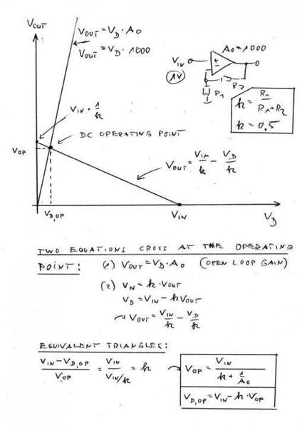

...but I am struggling with one concept. Say we apply a 1V step input, with an Aol of 1000, and a feedback factor of 0.5 (so ideal closed loop gain of 2), how does the op-amp "know" to stop rising at Vout = 1.996V?
The finite gain equation says Vout = Aol(V+ - V-), but in this case if V+ = 1V, and V- = 0.5(Vout), then Vout would have to be 1.996V in order for it to simultanteously be 2V. ? Since the input differential is dependent on the output, what is this equation even saying?
The op-amp does not "know" you want 2V on the output, per say...so what's stopping it from rising to 1.997V, and producing 1.5V on the output?
Here's how I've been thinking about it:
At first there's a large input voltage differential, (1V-0V), so the op-amp "tries" to reach a very high output voltage (1000V) but is physically limited by its slew rate. As the output rises as quickly as it can, it subsequently reduces the input voltage differential and thus it "tries" to reach lower and lower voltages. In this case, when the voltage reaches 1.99V, it is "trying" to reach 5V and at 1.996V, it is "trying" to reach 2V.
I'm just not sure how the op-amp says "this is a good place to stop!" when reacting to that step input.

4.) At this very moment (assuming an open-loop gain Aol=1E4) , the opamp is in its linear amplification region because the diff. voltage is Vdiff=Vin-0.99980004=1-0.99980004=0.00019996V.
As a result, the output voltage is Vout=Vdiff*Aol=0.00019996*1E4=1.9996001V.
Mathematically, it all checks out...My issue is, what physical phenomenon is causing the op-amp to settle at that (seemingly random) voltage? There is no little man inside the op-amp that you say "Hey I'd like to amplify this signal with a gain of 2". So what's the reason it does actually get very close to the voltage you want?

Vout = ((V+) - (V-)) * 1000
V+ = 1
V- = Vout/2
Calculate Vout. That is the answer. The amp just operates at that point. No iterations.

TimNJ said:
Mathematically, it all checks out...My issue is, what physical phenomenon is causing the op-amp to settle at that (seemingly random) voltage? There is no little man inside the op-amp that you say "Hey I'd like to amplify this signal with a gain of 2". So what's the reason it does actually get very close to the voltage you want?.
Tim - no, it is not a "random voltage". It is the only voltage which is possible and which meets the constraints imposed by all the oither parameters (open-loop gain, feedback circuit, supply voltage, input voltage,...).

Hello Tim - perhaps a graphical solution (visualization of the problem) may help?
In the attachement I have scetched two lines which reflect the electrcal rules which matters:
(1) the open-loop gain Ao (example: 1000) and (2) the voltage divider k of the feedback circuit - expressed also using the terms Vout and Vd (diff. voltage).
Therefore, both lines may be shown in a common diagram - and the resulting operational point is where both lines are crossing each other.
This is the only point which fulfills both equations.
Now - it is a simple matter to calculate the wanted pair of output voltage (Vop) and input diff. voltage (Vd,op). See the formulas on the paper.
Using the given values (your example), we arrive - of course - at the values as given already in my post as referenced in your first contribution:
Vop=1.996 volts and Vd,op=0.001996 volts.
More than that, it is very easy to verify that the result is stable because the sign of both slopes is different
(in case of instability the slope would have the same sign). Of course, the line (1) is not drawn true to scale. If you would draw it true to scale you can visualize the tiny difference between Ao=1000 and Ao infinite.

Yes! I am still here! I am so grateful for the insightful discussion this has brought about. I was actually studying for an engineering exam and just couldn't get around to logging on to PF.
Just to clear a few things up, I understand the ideal model very well, and for the most part I understand the finite gain model too. If the op-amp had infinite gain, it could only operate at V(diff) = 0, or else the output would saturate. As a model and a tool for designing op-amp circuits, it's very useful and simple. Eventually, we learn about the finite gain model, where we say that its gain is still very large, but definitely not infinite. So we can in fact have linear amplication, so long as we keep V(diff) very small.
Jim, meBigGuy a huge thanks to you two. LvW, I think your graphical representation was exactly what I was looking for (and maybe others too). I think the toughest part in understanding everything is that these two equations are interdependent on each other, and that it doesn't make much sense to isolate them. However, your graph shows how changing certain values, i.e. Aol and K cause the operating point to shift up and down. Increasing K causes the operating point to drop, while increasing Aol causes the slope of the V(diff)*Aol line to increase and subsequently raises the operating point. Very nice way to view the operation of an amplifier. Thank you so much for taking time out of your day to draw that up.
