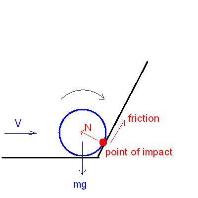

Taken literally, there is a sudden change from a level flat surface to a slope. If so, there's a sudden impulse when the ball hits the slope. Work will not be conserved. You can use a different conservation law to figure out what happens in that instant.

I seriously doubt the question is concerned with the sudden onset of the inclined plane.
I don't see why it's so unreasonable. You are given all the information to do it.
Otherwise maybe you'd also have to take into account the finite radius of the sphere and how that interacts with the "corner."
That's not an also - it's exactly what I'm referring to. It's not particularly hard, and the effect is quite significant.

No, that doesn't fix it. The fraction of energy lost depends on the angle of the slope, not on the radius of the sphere.

It fixes the problem that the sphere encounters the corner before the center is above the incline.
Only if you assume the transition from horizontal to incline has some smoothness. If it is an abrupt change, it makes no difference how small the radius is.
For the present problem (hollow sphere), the fraction of energy lost looks like this:
30o: 15%
45o: 32%
60o: 51%
90o: 84%
So in general it is an important consideration.
Now, it's quite possible that the problem setter also overlooked its significance. If so, I regard it as a poorly specified question.
Likes sulhar

Why can't this be assumed to be an "elastic but still sticking to the surface" interaction for the purposes of the problem?
Because that doesn't help. It would mean the lost energy is now in the form of oscillations in the ball, to be released as soon as the magic making it stick to the surface goes away.
I'm not being facetious. All you have to do is consider conservation of angular momentum about the point of impact. This will prove there's a loss of kinetic energy, and no tricks like the one you propose will overcome it.

As for the collision with the incline, the situation could be idealized to a totally elastic collision that somehow doeen't involve bouncing or the ball not internally twisting creating an angular oscillation that never dissipates or just happens to transition into zero internal torque at the moment the ball stops rolling.

How, other than supposing a smooth transition in the surface shape (which ought to be stated, not presumed)? Bear in mind that such an idealisation for an abrupt change in slope also means violating a conservation law. How would you justify that?
Can you explain why does the angular momentum abut the point of contact conserved when the ball starts to roll upward? Which point do you speak about? The one just the impact? About that, the impact force provides torque. At the instant of the impact the ball loses contact with the horizontal ground so it gets subjected by the torque of its weight.
