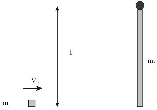

A mass m1 with speed v1i colides with a mass m2 of length 1m, initially at rest, and gets stuck with it.
(a) Express the angular velocity in functon of v1i. (m=m1=m2)
w=v/r
Since the collision is totally inelastic I can say
m1*vi1=(m1+m2)vf ⇔
Since all masses are equal I can say
vi1=2vf⇔vf=v1i/2
Since w=v/r
w=vf/r⇔w=0.5*v1i/0.5⇔w=v1i
This is wrong for some reason... Can anyone lead me in the correct way?
