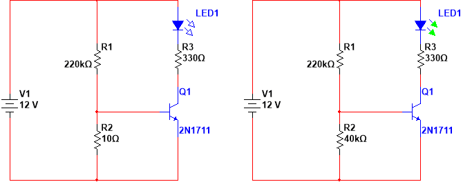

In the circuit above , I am not really sure how it work? when R5 is 10k ohm , BJT is in the on state and when R1 is increased to 20k ohm , BJT is in the off state
To fully turn on the BJT , Vbe must be greater than 0.7. I apply voltage divider rule , R6/(R6+R5) * 12 v = 1.091V. which is more than 0.7 so it turns on the BJT. Am I correct?
I am still learning how BJT work so I simulate this in Multisim. I am new quite new to BJT

I have insert the circuit with led in it and change the resistors location.
When R2 is 10 ohm , LED1 doesn't light up. When R2 is increased to about 40k ohm , LED1 light up.
May I know how this circuit work? Why does the increase in R2 will lead to LED1 begin light up?

Left circuit: current through R1 ~ 12V/220K = 0.055mA drops only 0.055 mA x 10 ohms = 0.55 mV across R2, not nearly enough to turn on the transistor which requires about 700 mV b-e volts to turn on.
Right circuit: current thru R1 ~ 11.3V/220K = 0.052 mA but the current into R2 is now only 0.7V/40K = 0.018 mA so the remaining current = 0.052 mA - 0.018 mA = 0.034 mA can flow into the transistor base.
You should study the relationship between ic and Vbe for a bjt. Essentially it says that very small ic flows until Vbe approaches at least 0.5V: ln (ic) ~ Vbe/26mV at room temperature.

The LED carries the collector current, the LED being in series with the collector lead. When the switch is well-designed you'll see plenty of collector current flow whenever there is plenty of base current. The base gets its current through R1. Resistor R2 can control the base current: if R2 is relatively low resistance it can divert most of R1's current to ground and leave very little to go into the base, thereby preventing collector current from flowing.
