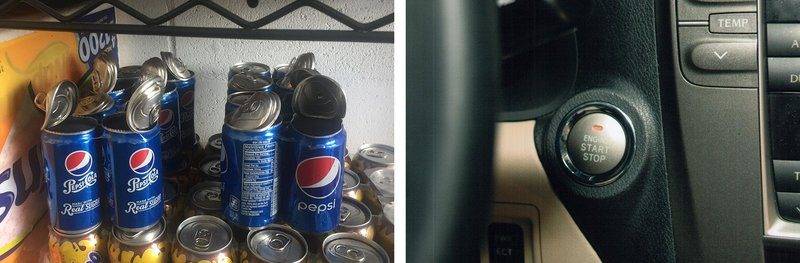

How does carbon monoxide cause soda cans to explode?
In summary: And found the cars in the garage with the key fob off. The carbon monoxide was building up in the garage. The cars were running, but the key fob was off, so they didn't realize the car was running.

Look at the photograph of the exploded cans of Pepsi. They all failed at the seam around the lid. Moreover, the Pepsi cans are staked atop other cans that appear to be identical except they contain some other kind of beverage. I can't tell from the little bit of can that shows in the photo, but they appear to cans of soda also. Perhaps Mountain Dew? Can anyone tell?
I believe Mountain Dew and Pepsi are made by the same company.
My first guess is that there's a seal around the lid of the Pepsi cans that fails in the presence of carbon monoxide.

Look at the photograph of the exploded cans of Pepsi. They all failed at the seam around the lid...
Well:
1. Google tells me CO is not corrosive at low concentrations and atmospheric pressure.
2. As far as I know, the seal is mechanical: it is crimped.
3. You can see the kids are bulged from being under excessive pressure.

I wouldn't call what I saw in that photo an explosion. If anything, it looks like a safety mechanism was activated to prevent an explosion.

Is what we see in that photo consistent with that explanation? Only the Pepsi cans failed, and all the Pepsi cans failed. And all at the same place, the seam around the lid.
Perhaps the cans froze over winter and ice pushed out the tops?
Not a physicist, but it looks like the cans below Pepsi are YooHoo, not carbonated. In the NYT picture, there looks like Pepsi residue on the lids of the cans below- especially on the right (but not as much as one would expect) and little bits of spatter on the package of what looks like paper towels to the left, and plastic sheeting on the right. Heat would make sense, think of all of the heat energy in a gallon of gas, let alone however many were burned while the car was idling. Truly sad, however.

The Pepsi cans are higher up than the other cans, and stratification is pretty substantial in a situation like this. And there are other potential factors: they may not be identically constructed, the liquids may not be identical and the ones on the bottom may be sitting on something that could conduct heat away.
Also, if you look closely at the pictures you can see the tops themselves are bent outward, indicating they were substantially pressurized before the crimp let go.

To me, the key that says elevated internal pressure is the fact that all the tops that failed popped from concave to convex, indicating higher than normal internal pressure before the seal/crimp joint gave way...plus several cans that didn't open up still have their tops popped convex.
Unfortunately, I've experimented with this myself...
Perhaps it was the heat of the engine running in an enclosed garage that did it. But... if the cans opened from heat while in the location shown in the picture there should be quite a sticky mess.
There are actually two kinds of Pepsi in the picture. I am going to guess the guy wanted to do a taste test and impatiently put them in a freezer to chill. They blew up then he took them out. Later on he died.

Copied the photo from the NYT article, I will post it.

Thank you! That picture was nowhere to be found when I looked at the article.
Perhaps the cans exploded because of the heat?

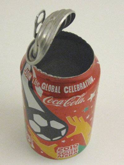

The culprit was undoubtedly heat. Check out a can of Coke left in a car in the hot sun:
http://www.philly.com/philly/news/y...nough_to_explode_a_Coke_can_inside_a_car.html
Look familar? The heat drives the CO2 out of solution, cramming the gas into the small dead space above the liquid. When the lid blows off, the gas escapes, and the liquid is left sitting there largely undisturbed.
(The drink in the yellow cans is Yoo-Hoo, which is not carbonated and is therefore immune to this problem.)
Possibly related to the heat from a running engine, in a closed garage, in Florida, but it has nothing to do with the carbon monoxide.

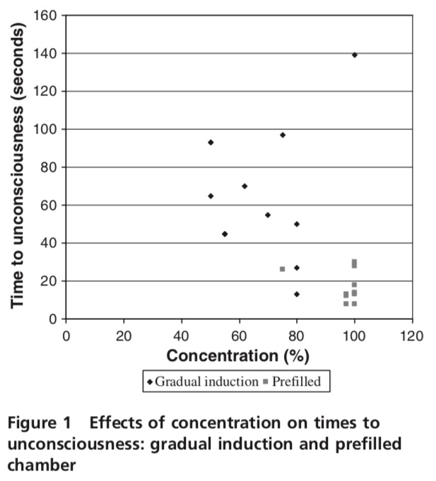

In a previous post, I mentioned the suicide by car tactic, where you use a garden hose to pipe exhaust into the car cabin. With this tactic, there should be almost no carbon monoxide in the car cabin (per previous post about how little CO cars actually produce*), but after just a few minutes pretty much all of the air will be replaced by CO2 and water vapor. Thus it is my belief that it would be CO2, not CO, that would kill you.
*Short version: in order to produce a significant amount of CO you need to significantly choke-off the oxygen supply to the combustion and the car ECM has to be unable to compensate. In other words, in order for the engine to produce a significant amount of CO it first has to replace a significant amount of air in the garage with CO2. If you pipe your exhaust into the cabin of the car, the engine is getting normal, fresh air for a while, so it should be producing almost no CO.

In high concentration, CO2 will kill you very fast and rather painlessly.
And for that reason, it is used to euthanize animals.

russ_watters said:
It of course depends on how much.
You need much less CO than CO2.
https://en.wikipedia.org/wiki/Carbon_monoxide_poisoning#Signs_and_symptoms
https://en.wikipedia.org/wiki/Hypercapnia#Tolerance
In some scenarios maybe. But here the victim was found in the house, not in the garage. Reaching lethal levels of CO2 in the entire house seems unlikely. The article names CO as the cause of death, and states that the levels in the house were "at least 30 times the level that humans can tolerate". This cannot refer to CO2.
