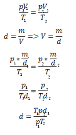

In temperature 273 kelvin and pressure 1.013*10^5 Pa, the density of nitrogen is 1,25 kg/m3. Find the density of this gas in temperature 330 kelvin and pressure 1.40*10^5 Pa.
T1=273 K; p1=1.013*10^5Pa; d1=1.25 kg/m3
T2=330 K; p2 =1.4*10^5 Pa. d2=?
p1V1/T1=p2V2/T2
https://image.ibb.co/bxkPAa/phys.png
d2=1.43 kg/m^3
Looks good. What's your final result?
d2=1.43 kg/m^3
annalian said:
d2=1.43 kg/m^3
Good!
