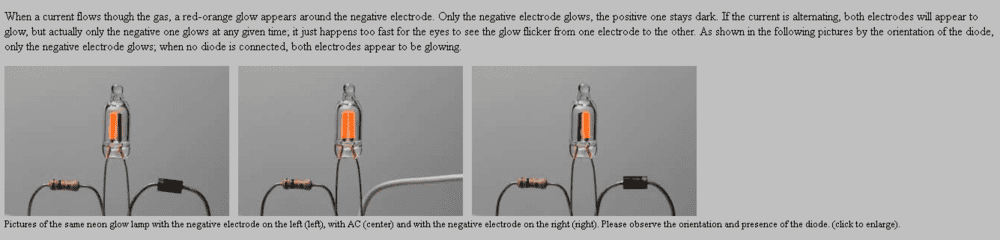

Those neon testers do give a clue to the attentive eye, though, if they're resistive coupled and can find a DC path through your shoes to 'ground'..
DC makes only one electrode of the neon lamp glow.
AC makes both glow, but alternately, and that looks continuous to the eye
244205
Image is from an interesting article here
http://www.giangrandi.ch/electronics/neon/neon.shtml
