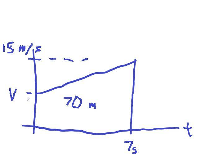

Plot velocity versus time.
The Area under the curve is the distance traveled for a given time interval.
Using the formula for volume of a trapezoid...
A =h (a+b)/2
Where:
a=v
b=15 m/s
h=7 s
A=70 m
then
70=7(v+15)/2
140/7=v+15
v=20-15=5
