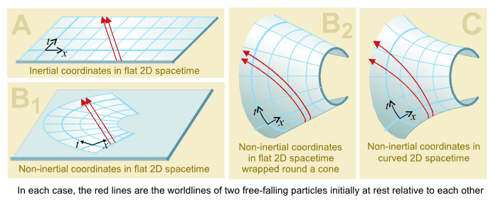

Xcourrier, If you haven't seen it already, check out this post by DrGreg:
https://www.physicsforums.com/showpost.php?p=4281670&postcount=20
Note that all worldlines in the diagram are geodesics (locally straight lines). So they have no proper acceleration (what an accelerometer measures, a frame independent value).
But they change their direction relative to some of the coordiante charts. This indicates coordinate acceleration (change of velocity in some reference frames).
So when you think about acceleration, it is important to keep these two concepts apart.
