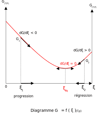

If so, then can we tie this together with Gibbs Free Energy? Because I've seen in notes and books that ΔG=0 but then again since ΔH represent the different in final and initial states ΔG should also be so. So it shouldn't be dG=0 instead?

You will run into serious problems here because of ambiguity in the definition of ΔG typically used.
dG/dξ = 0 at equilibrium, yes. But ΔG = 0 too.
This is because of the (non-trivial) fact that dG/dξ evaluated at a certain extent ξ1 (which itself is defined as coming from your set initial state) is equivalent to ΔG, that is change in G between the initial state (ξ=0) and that extent ξ1 being considered. This should require detailed proof for you and it is available on Wikipedia. http://en.wikipedia.org/wiki/Chemical_equilibrium
Because dG/dξ = ΔG for all ξ, in any process, and dG/dξ = 0 by definition at equilibrium (since we have a minimum in G at equilibrium), ΔG = 0 (as ξ for equilibrium is just one particular value of extent for a given process). This is a subtle truth. Meanwhile, dH/dξ does not equal ΔH in general. So while dH/dξ = 0 at the equilibrium extent, ΔH does not (rather, it represents what you throughout high school chemistry etc. knew as "the enthalpy change of the reaction" - the change in H that occurs when the system goes from initial state to equilibrium "completion" - and that is all we can say about it).

Thanks for the insightful reply I have read the proof from the wiki page but I can't really understand it. They ended with dG/dξ = ΔG = 0 But how can this be so?
From the diagram they gave us shouldn't ΔG be Gξeq - Gξinitial giving us a negative value instead of zero?
