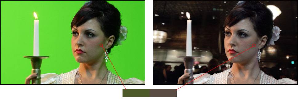

I get the basics of green screening. The processing software recognizes a small range of green and can substitute a different image where it occurs.
Here's what I don't get: if a subject is standing in front of a green screen, they will have reflections of green.
Notice that, in the pre-processed image, the candle base, her hair scrunchie, the hollow of her cheek and even the nape of her neck all have a noticeable green cast to them. The rest of her face will not have a green cast.
The naive assumption would be that they could compensate for this by reducing the green - but it can't be as easy as that. You'd have to process only the affected portions.
Two different areas of her skin for example, will need different treatments. You'll want to reduce the green in portions that are inclined toward the background, without altering adjacent areas (otherwise she will end up with a magenta cast).
The right patch of skin is too green, but the left patch is adjacent, and yet should not be processed, or it will be too magenta.How do they do this?

I do not see anything else green on her so perhaps they just get rid of all the green and not just the specific shade of green used on the green screen background. This would only become a problem if the target itself was wearing / holding anything green which is easy to avoid with some common sense advance planning.
I think the green color has some very specific RGB values. I can't say they are the same for all pixels but highly unlikely to occur in a picture unless its an area you are masking out.

In the articles @jedishrfu linked, they mention bright green screens. That suggests that it is not just color, but color plus brightness that is the key.

The two big ways to avoid reflections of the green screen on the subject involve the staging (distance between subject and background) and lighting of the scene.
The green most often used is a specific bright green, not commonly found in human skin tones. Other colors may be substituted (software permitting) if you have problems with particular subjects (like Capt Kirk's green woman).
The subject should not be too close to the green screen. Separation will reduce the strength of any reflected green.
Separate lights should be used for the background (to illuminate the green screen), for the subject (consider classic 3-point lighting: key light and fill light, and backlight (if you want to provide outlining of the subject)).
Bright direct lighting of the subject will usually swamp out any small amounts of reflected green.
The green that is removed by the software is pretty specific and (depending on the software) can be to leave or remove more of particular colors. It does not remove just any color with green components, it is pretty specific (as mentioned above).
You can make yourself a floating head, by wearing a green screen suit in front of a green screen and then using the same software. Or make you hands go away, or whatever.

Certainly some of the candle base will reflect light from the green screen, but the hollow of her left cheek shouldn't have a green tinge unless the screen is so wide that points on the screen well off to her left can reflect off her cheek..
There are programs that identify the outline of anything that is on a constant-color background so my assumption has always been that that's what is used when some of the subject itself is pretty much the same shade of green as the green screen. Since photography (including video) is digital these days, the technique can be applied frame by frame for videos.
I could be wrong and it could be just a simple recognition of color plus brightness.

Many of the proposed solutions are ignoring the example given, where there clearly is some green reflected onto the skin and successfully removed. They must have done that some way. I think that the suggestions should focus on that example instead of proposing alternative situations.
Likes Orodruin, russ_watters and Dale
I agree. The fact that there are secondary green reflections in some circumstances is clear. It may be that they could be avoided sometimes, but when they are not avoided, then what?

You know the colour balance of normal skin, so you can identify green tinted skin and remove the excess green illumination to restore the colour balance.

It is not nearly that simple.
  1. There is no such thing as normal coloured skin. There are as many skin colours as there are people on the planet.
  2. The only time you would see a given colour of skin as its natural colour is in a neutral grey environment. In other words, every environment will have elements that shed more green light and/or less green light on a subject. You can't just unilaterally remove - or leave - any green.
  3. What about every other object in the subject? 'Normal colour' for hair? 'Normal colour' for cream dress? 'Normal colour' for candlestick? etc...

You have a colour sample of everything you need in that photo. If you can see green bleed then you can see where there is no bleed, so you can apply the colour correction.
Except that means you'll be applying it to specific areas and not to other areas - areas that will change over the duration of the scene. That seems like a vast amount of processing power.
As an experiment, if you took the above example - just a single frame - and Photoshopped it, I think you'd find it took some effort. Now imagine doing that across a thousand frames. Now try to get software to recognize the applicable parts of a human face to correct.
