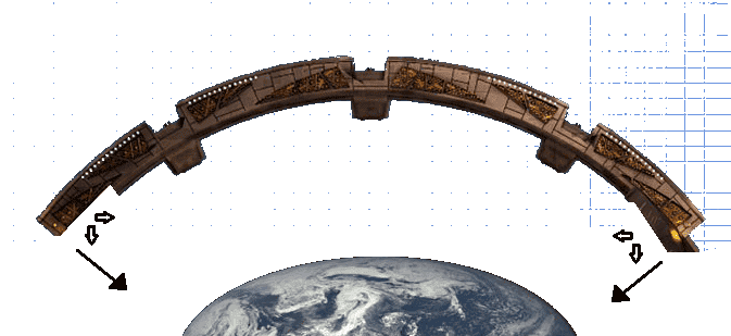

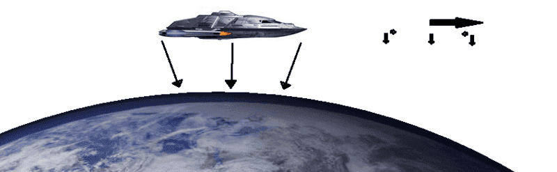

Maybe a molecule in orbit, but an object in orbit is subject to multiple forces, example:
Likes Buckethead
I like the book in the car example. If we were filming the car turning and the book sliding from above, would we then clearly see the book actually continuing in the original direction of travel, i.e., straight ahead? Starts to sound like Einstein to me. Different descriptions of motion depending on the P.O.V. of the observer. Similar to the tossing a ball straight up and down in a passenger car of a moving train, and the "actual" trajectory of that same ball for the observer standing besides the track, seeing the ball following a string of parabolic arcs back to the tossers hand.
Likes KurtLudwig
Tidal forces. OK, I'll go with molocule.
Likes paradisePhysicist
Also the wikipedia says this of tidal force: "It arises because the gravitational field exerted on one body by another is not constant across its parts: the nearest side is attracted more strongly than the farthest side. It is this difference that causes a body to get stretched. Thus, the tidal force is also known as the differential force, as well as a secondary effect of the gravitational field. "
I think that is not the full story; while the gravity vector strengths are different in most cases, also the object is subject to stretching, or rather, compressive, forces due to that the directions of the different gravity vectors are at different angles. Example is a space station that matches the Earth's curve exactly:
Fmass
That is not totally true, for the body of the figure to remain in a stable orbit (circular, elliptical) the centripetal force is equal to the gravitational force, for any portion of mass. You are just neglecting the inertia, due to the change of direction of the velocity, only if you drop with zero velocity at the beginning you will see the approach of the extremes, and it is not due to the change of the module of the acceleration of gravity with the height, but to the change in the direction of the acceleration vector that always points to the center, no matter how dense or massive the object is.
If you rotate two objects of mass #m# joined by an inextensible string in a circular orbit, the string will not lose or gain tension due to the tidal force of the Earth's mass, only with the passage of time it will shorten due to the gravitational attraction of the masses #m# of the objects themselves.
Centrifugal force does not exist, its a made up force. Imo, centripetal is sort of made up as well. This is quoted from physicsforum.com:
"4. Centrifugal and Centripetal Forces These are two ways of describing the force on an object associated with its movement in an arc. Centripetal view X “In an inertial frame, the centripetal force is the applied force that makes the object move in an arc.” Centripetal force is a resultant force, not an applied force. ✓ “In an inertial frame, real applied forces have a real resultant force producing all the acceleration. The component normal to the velocity is termed the centripetal force. Arguably, it is better to avoid the term centripetal force altogether and only refer to centripetal acceleration
Source https://www.physicsforums.com/insights/frequently-made-errors-pseudo-resultant-forces/
In this case its combining the gravity force with the linear inertia. All the planets are spheres, I assume this has something to do with gravity compressing and bending stuff. As for your string theory, idk I just got up, but later today I will try to run it in the simulation and see what happens.
