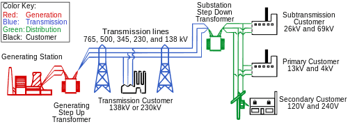

As berkema mentioned, the Wikipedia page on http://en.wikipedia.org/wiki/Electric_power_distribution" is a good general source. The first section gives a pretty good overview of why this is so complicated:
The modern distribution system begins as the primary circuit leaves the sub-station and ends as the secondary service enters the customer's meter socket. A variety of methods, materials, and equipment are used among the various utility companies, but the end result is similar.

The http://en.wikipedia.org/wiki/Electric_power_distribution" mentioned above has a simple diagram that may help (although, it doesn't show the neutral or Earth connections.)

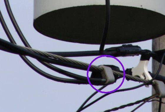

Could someone confirm if what I'm saying about this picture is correct:
http://en.wikipedia.org/wiki/File:Polemount-singlephase-closeup.jpg
[URL]http://en.wikipedia.org/wiki/File:Polemount-singlephase-closeup.jpg[/URL]
There are three thick insulated black wires which are the split phase secondary winding, and the center wire should also be grounded (since it's the neutral wire and neutral is grounded), but you can't really see that in the picture. One of the leads of the primary winding is entering the bucket through the top, and is one of the three phases. But there needs to be another lead for the primary winding, and there seem to be two other wires, on the right side of the bucket, at the top and bottom. The Wikipedia article suggests that one of the three phases and a ground wire are the primary leads to create split phase, so I'm assuming that the two wires on the right side of the bucket are ground wires. But why are there two of them?

Looking at the image in http://upload.wikimedia.org/wikipedia/en/1/1c/Polemount-singlephase-closeup.jpg" , I can see the second primary lead connected to neutral/ground (the uninsulated cable), along with the secondary center conductor, and the steel case of the transformer (the lower connection seen toward the ride side of the image). The neutral is connected to the house as a bare steel wire, which doubles as a structural support/strain relief for the two conductors.
The neutral-primary and case-to-ground connections on the transformer are separated in that manner as a type of redundancy. The reasoning, as I understand it, is to insure a solid connection to ground (earth), should there be an interruption of the neutral wire. I don't know enough of the electrical theory to understand how it would be any different than simply connecting the neutral and earth-ground to the same terminal.

I don't see how the secondary center conductor (the middle black wire) is connected to neutral/ground. That middle black wire seems to end at a dielectric spacer that separates a ground wire (the wire where you can see the braids) from other wires.

That connector (circled below) is metal, not an insulator. The white three-armed piece to the right is an insulating standoff. Farther right is another metal connector that attaches the household neutral.
