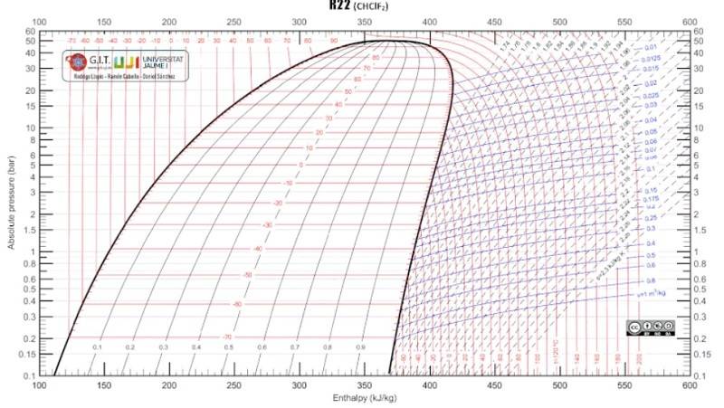

Spend some time studying pressure enthalpy diagrams (search the term). This one is from https://en.wikipedia.org/wiki/File:R22_ph.gif.
For example: Start with saturated liquid R22 at 250 kJ/kg. According to the chart, the pressure is about 16 bar. If you reduce the pressure without adding or removing heat, you follow a path straight down on the chart. Decrease the pressure to 0.1 bar (bottom of the chart) at 250 kJ/kg. The quality is 0.54, meaning that 54% of the liquid R22 has flashed to vapor.
If you add or remove heat at constant pressure, say in an evaporator or condenser, then that process follows a horizontal path on the diagram. Liquid or vapor can change temperature, or the fraction of liquid to vapor will change.
