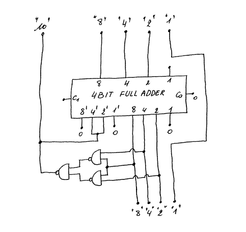

In summary, a 3 bit 2 input multiplier has a maximum of 6 bits and the max integer product is 49. Problem is I have no idea displaying it in 2 seven segment displays since the 74LS48 decoder only has 4 inputs and 7 output, only good for a single 7 seg. And we are required only to use ICs which is rather costly for us. I thought about using a multiplexer but that would be too costly since it would have a lit of AND gates. There are ICs doing binary -> BCD conversion. And they are certainly cheaper than hundreds of individual logic gates. That conversion is messy, there is no easy way of doing it. How about using a ROM, look up table

So a 3 bit 2 input multiplier has a maximum of 6 bits and the max integer product is 49. Problem is I have no idea displaying it in 2 seven segment displays since the 74LS48 decoder only has 4 inputs and 7 output, only good for a single 7 seg. And we are required only to use ICs which is rather costly for us. I thought about using a multiplexer but that would be too costly since it would have a lit of AND gates.

I thought 74LS48 ICs were Binary to BCD ones? Are there more?
74LS48 is BCD to 7 segments for a single digit. You have to split up your 6 bit binary multiplication result to the two digits.

I did some digging and found out using Binary to BCD method. Problem is the 85 ICs have been phased out for decades according to some forums. I'm trying to replicate it using a 4 bit adder IC (74LS83) and a comparator circuit gates so it adds 3 whenever the output goes beyond 4. I'm having no luck on Logisim whatsoever. Since the inputs are 6 bits, bit number 6 and bit number 5 goes into the 1st 74LS83? And should I add 3 to these 2 bit inputs on the first 83?
The second image is the closest I could find but it's a BCD to Binary one:
