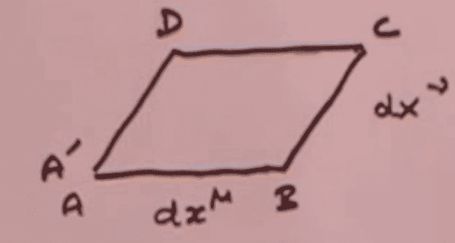

How does parallel transportation relates to Rieman Manifold?
In summary: So in summary, the video talks about how moving from A to A' in an anticlockwise manner will give a vector that is different from when the vector is originally in A in curved space.
TimeRip496
254
Source:
Basically the video talk about how moving from A to A'(which is basically A) in an anticlockwise manner will give a vector that is different from when the vector is originally in A in curved space.
$$[(v_C-v_D)-(v_B-v_A)]$$ will equal zero in flat space.
$$[(v_C-v_D)-(v_B-v_A)]-[(v_C-v_D)-(v_B-v'_A)]=v_A-v'_A$$
$$v_A-v'_A=dv$$
That is the difference, that is going to be the change in the vector as it is parallel transport around that parallelogram. In flat space, dv will be zero as the vector will be parallel transported and come back in the same magnitude and direction. but in curved space, there will be a difference, not in length but in angle of the vector.
$$v_C-v_D=\frac{∂v}{∂x^μ}dx^μv⇒∇_μdx^μv$$
change in vector between c and d is the gradient multiplied by the distance times the value of the vector. We need to use the covariant derivatives so instead of using the partial derivative, we use this ∇ instead.
$$(v_C-v_D)-(v_B-v'_A)=∇_μdx^μ ∇_νdx^ν v$$
I don't really understand this part. Like so just by derivative can we actually change the vector twice?
$$v_A-v'_A=dV=dx^μdx^ν v [∇_v.∇_μ]$$
And the commutator between the two covariant derivatives will give the Riemannian Tensor, which can be regarded as the Ricci tensor.
So how does parallel transportation relates to the Riemannian manifold? Does the Riemannian manifold exhibit the above properties? Do I need to learn about differential geometry in order to understand Riemannian manifold?
Think of the Earth. Stand where the Greenwich meridian crosses the equator and hold a vector pointing North.
Walk up the meridian to the north pole, parallel transporting your vector. That means always keeping it pointing the same way it was a pace ago. When you get to the pole you should find that it's pointing straight down the 180° meridian.
Start again at the equator but walk along the equator to 90° east. Your vector should still be pointing north. Now head up the meridian until you reach the pole. Your vector will be pointing along the 90° west meridian. It is not parallel to what you got from the first procedure.
This is a general feature of curved spaces (it's not an effect of meeting at the pole or anything). The notion of "the same direction at two different points" is path dependent.
The covariant derivative measures the change in a vector along an infinitesimal displacement - it parallel translates the vector. Using it four times around an infinitesimal parallelogram is the "at one point" formalisation of my triangular trip round a sphere. The resulting information is encoded in the Riemann tensor, which describes the curvature of the space (or spacetime, in GR) at that point.
