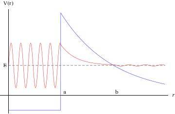

Tunnelling can be seen from the wave standpoint as well, and it's much less "weird". You should look at the WKB approximation for tunneling, in which you can do a fairly realistic model for an atomic barrier using a Coulomb potential (blue):
The wave (pink) incides on the barrier, and doesn't lose energy or change its nature (see the same frequency of the wave outside and inside) but the probability amplitude outside is less than the inside (see the amplitude of the wave). Though since it's actually the wavefunction of the particle, finding it outside means that the particle has tunneled.
