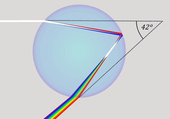

It's fairly neat, actually. I used to run the demo in physics lab to show students how the light is reflected inside a droplet. Here is a picture (linked from Wikipedia).

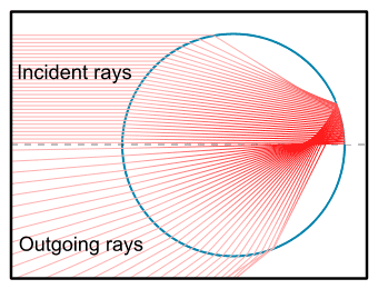

Now, this shows only a tiny slice of light entering the droplet. What happens is that light that enters the droplet at that point exits at the angle shown. Light entering anywhere else gets mostly scattered. Here is another picture to demonstrate that (also Wikipedia).
You can see that the rays exiting at the angle shown in the first picture are densely packed and all travel in the same direction. All other rays diverge. That means that if you have a droplet illuminated by a distant light source, as you go around the droplet, there will be a point where droplet will appear really bright. Furthermore, that angle depends on wavelength of light, so it will appear to change color.
Finally the arch formation. A single band in the arch is collection of droplets that you view at that special angle. Collection of points such that the angle from you, to the droplet, to the source of light (usually the sun) is fixed is a circle in the direction opposite from light source. Since light source is normally above you, most of that circle ends up clipped by ground level, and you end up seeing only an arch in the sky.
There are several additional effects you can see. There are other paths light can take in the droplet which also produce a faint image at a different angle. That's seen as a second rainbow over the main one. Near large body of water you can sometimes see a rainbow formed by Sun's reflection in water. This only happens in very calm weather and is also much fainter. Since the source now appears to be bellow you, this one is above the main rainbow and arches upwards. Sometimes, it can make a full circle. You can also get rainbows from artificial light sources. These can also appear as full circles in the air.
