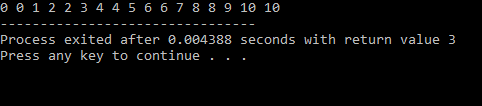

What compiler are you using?
I'm using Dev C++. Check this out.
Code:
#include <stdio.h>
int main () {
    int x;
    x = 0;
    while(x <= 10) {
        if (x%2==0) {
            printf("%d ", x);
            printf("%d ", x);
        else printf("%d ", x);
        x = x+1;
Here's some code I wrote for homework. Notice that there isn't a "return 0;" at the end. If you run the code on Dev C++, this happens.
Why is the return value three?
Code:
#include <stdio.h>
int main () {
    int x;
    x = 0;
    while(x <= 10) {
        if (x%2==0) {
            printf("%d ", x);
            printf("%d ", x);
        x = x+1;
That's the value that happened to be in the AX register when main() exited. If you had included "return 0;" in your code, that's the value that would have been returned.

dect117 said:
As mentioned in my previous post, the C standard specifies that running to the end of a main function will result in a "return 0". Since per the C specifications, your code is a valid main function, this function should return 0. The fact that it does not means that your compiler does not comply with the standard.
Instead, your compiler seems to have treated this as a regular routine and left the return value unspecified. As @Mark44 noted, on Intel machines, C is normally implemented by returning integer values through the AX register. By not setting the AX register to a specific return value, it was left at whatever value is had from its last use - probably related to the printf statements.
Code:
#include <stdio.h>
int main () {
    int x;
    x = 0;
    while(x <= 10) {
        if (x%2==0) {
            printf("%d ", x);
            printf("%d ", x);
        x = x+1;
Well are you using C or C++? There are many subtle differences between them and there are different versions of both C and C++. For example, historically there have been at least four different versions of the C language:
  • The original C, described in the first edition of The C Programming Language by Kernighan and Ritchie, published in 1978.
  • ANSI C or C89, defined by the 1989 ANSI standard.
  • C99, defined by the later 1999 ANSI standard.
  • C11, defined by the 2011 ANSI standard.
C++ and versions of C starting with the C99 standard follow the "implicit return 0;" rule at the end of the main function. The older C89 version of C doesn't. So you could have got the result you did if Dev C++ compiled your code using a C compiler and it was conforming to the C89 standard.
