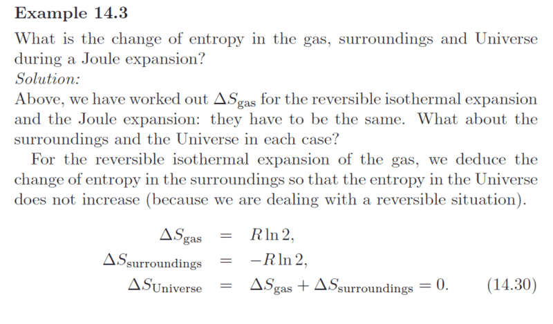

How does a reversible process in the universe imply the entropy doesn't increase? I understand that the change of entropy in a closed reversible cycle is 0 in the system, but I don't get why a not closed reversible process in a system can imply zero change in entropy in the universe.

But this thread is not about an irreversible processs, it is about a reversible process, so Clara has not included the complete example. In the part of the example given, equation (14.30) and the equation preceding it are for a reversible isothermal expansion. In the part of the example not included, expressions are given for an irreversible Joule expansion.
I have no idea what you mean. Joule expansion is an irreversible (spontaneous) process.
For completeness, I give below the complete example and the section from which the example is taken. In this particular thread, Clara is asking only about the solid line process of Fig. 14.5.

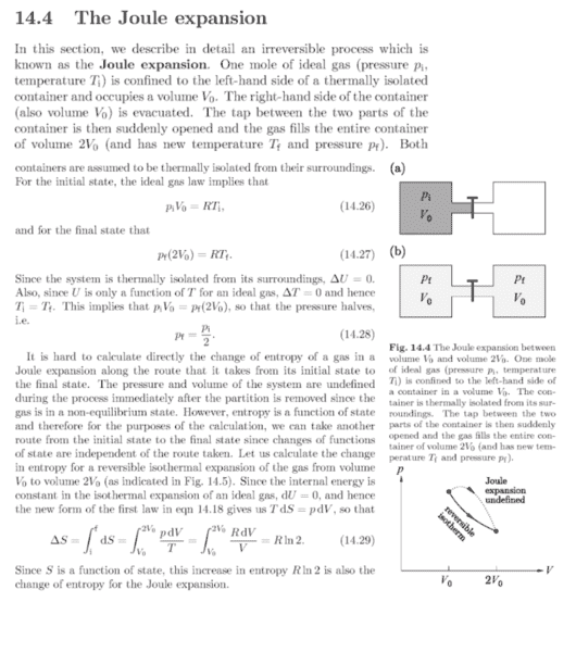

I am sorry for not posting the whole section. This is the "above" section and I think the problem is discussing about the devised reversible process from two equilibrium states...(not the joule expansion.)
If the process is irreversible, the entropy change of the gas is still the same as the reversible process. However, in the universe the change of entropy is an upper bound of the integral of q'(t)/T, so the change of entropy must be larger than 0.
You are correct that it is discussing the devised reversible process. However, the devised reversible process has the same two end states as the irreversible Joule expansion. And, as I said in Step 2 of my Insights article, you need to totally forget about the actual process path when determining the change in entropy between the end states. It is no longer of consequence. The only thing that matters is the two end states.
Yes.
We can determine the change in entropy of the universe and the change in entropy of the surroundings in a precise manner for the Joule expansion. Here's how. We now focus on the surroundings and treat it as a second separate "system" that can experience a possible change during the Joule expansion that occurred in the primary system. Treading the surroundings as a second system, please describe the change in the thermodynamic state of the surroundings between its initial and final states, when the gas in the closed insulated primary system experiences an irreversible Joule expansion.

Now I forget about the irreversible and define a reversible process from the initial state to the final state which the macroscopic properties are well defined in the process. The step is an isothermal expansion from V0 to Vf, the entropy change in this reversible process will be nRln(Vf/V0). Also, after the isothermal expansion, the pressure matches the pressure of the final state in the irreversible process.
And the change of entropy of the universe will be the change in entropy of the second system plus the change in entropy of the first system...

You can also now see how the answer in your book for this problem is incorrect. You have shown that, as expected, the increase in entropy of the universe for the irreversible Joule expansion is greater than zero.
Now what you need to do is get some practice applying this methodology (to lock it in). Maybe an interesting practice problem might be the one we discussed in the other thread, which also features an initial temperature difference between the two chambers. If you decide to go ahead with this, I will specify the problem statement in a precise manner.
Maybe I am missing something, but how is this different from the answer given in the example from the book? The book's answer also gives that the increase in entropy of the universe for the irreversible Joule expansion is greater than zero.
That's not what the image in post #1 seems to show. What am I missing?
The image in post #1 is a subset of the images that I gave in post #8. The example starts on the page 145 and continues on to page 146. The three equations labeled (14.30) at the bottom of page 145 are for a reversible isothermal process. The three equations (14.31) at the top of page 146 are for the Joule expansion.
Sorry about the quality of the images; I had to zoom my browser to read them.
Aah. You can see how the OP (and I) got confused.
I think that, as a result of our efforts, her understanding has greatly improved.
