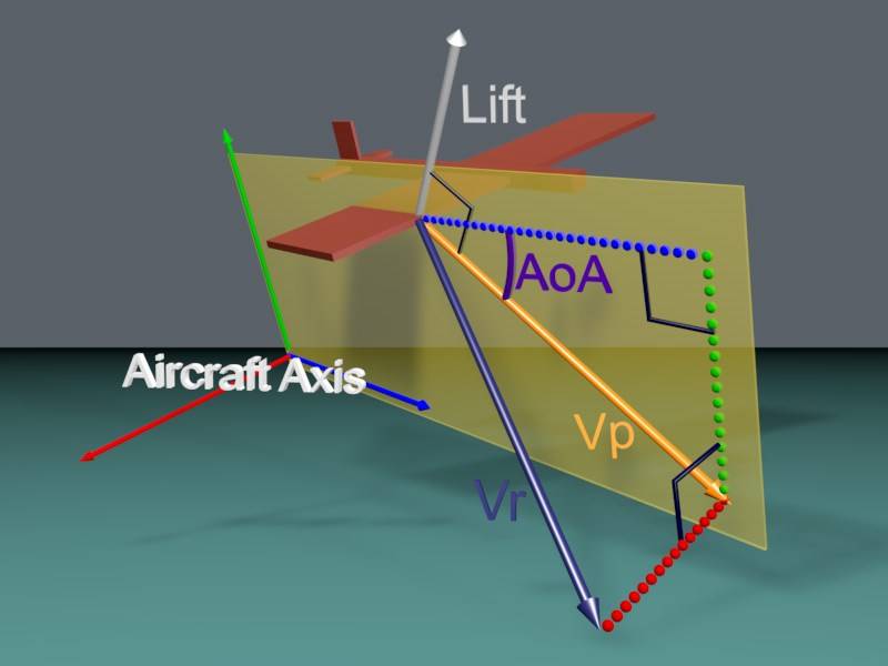

This is what I have been asking. They say a picture is worth a thousand words. Is the following the correct way to calculate all the entities (explanation follows):
I forgot to include the axis labels: x is red, y is green and z is blue.
The yellow plane is the y-z plane, relative to aircraft (wing) coordinates.
Vr is the "true" relative velocity. Once again, relative to aircraft coordinates.
Vp is Vr projected onto the y-z plane. As seen in the image, if Vr = <x,y,z>, then Vp = <0, y,z>. You basically zero out the x-component. Actually what I was asking in the OP :rolleyes:
So,
1. Is the angle marked AoA the correct one?
2. Do I use the length of Vp as the wind speed in the lift equation, and not Vr?
3. Does the lift vector also lie in the y-z plane as shown? ie. is it perpendicular to Vp, and not perp. to Vr?
The x-component which was zeroed out would be added back in at the end and basically only affects ground speed.
Have I got this right? Because it's what I was doing in the first place.
It's correct for the AoA of the wings, but you don't show the AoA for the fuselage, which would be the angle between the projection of Vp and Vr onto a plane parallel to the x-y plane but going through the center of the aircraft. It would be better if the z axis went thorugh the center of the aircraft.
The length of Vp is the wind speed for the up force equation, not the total lift (which would also include side forces from the fuselage).
Only the "upwards" component of lift lies in the y-z plane. There's also a "side" force from the fuselage, in a plane parallel to the x-y plane going through the center of pressure of the fuselage, and this side force is the other component of lift.
The drag force would be in the direction of -Vr.
Sorry rcgldr, that diagram is just for the lift produced from the wing. I know there are other forces to calculate. But the important thing was that I had this right since the same equations are used for the tail etc. And yeah I have the drag force worked out too.
It would be better if the z axis went through the center of the aircraft.
The axes are just to show orientation of the plane, and what coordinates I'm using. Since I think most books have the aircraft pointing in the x-axis rather than the z-axis. It's a "see what I was talking about" thing, not a "this is what I'm doing". In the sim I'm actually calculating lift at several points of each surface, not just one.
But do you see what I was talking about "zeroing out the x-component", and "projecting the relative velocity onto the geometric plane"?
In that case the diagram looks ok for the simplified calculation of upwards force from the wing. Normally the yaw angle on an aircraft is very small except for knife edge flight.
