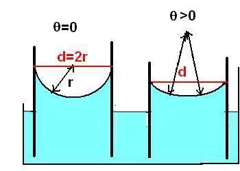

Calculate the force required to separate two glass plates of area 10 cm^2 each , with a film of water .5mm thick between them . take the coefficent of surface tention (T)to be 72 dyne/cm and theta = 0
The Answer written
since theta = 0 so the radius of curvature of the cylindrical surface between the plates is r = d/2 =.025 cm
((note : I Understand this but what If theta was another angle ??))
Delta P = T/r = 72/.025 = 2880 dyne/cm^2
the Normal force required = Delta P * Area = 2880*10 =2.88*10^4 dyne = .288 N #

Zero contact angle means that the wall is tangent to the liquid surface. There are two parallel walls at distance d, therefore the radius of curvature is r=d/2. This is not true for other angles.

Yes I do know that and I wrote that above , I asked what would be (mathematically) the radius curvature if theta was 30 degrees for example
Any way it is not my basic question here :D
I found some answers , but what I can't well understand is
how the pressure difference between the water and the air due to the curviture is multiplies by the (whole area) of the sheet , why ?
