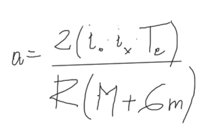

The thread ended up with the equation:
where
τ - 200Nm engine torque provided on each wheel
R - 0.35m wheel radius
M - 1000 kg mass of the car without wheels
m - 15kg mass of each wheel
After plugging in the numbers
the a=1,048 m/s^2
If a=V/t in the uniform accelerated motion, the t=V/a.
As I'm trying to figure out 0-100km/h acceleration (27,777m/s), after plugging in the numbers
t=26,5sec............ which is very long.
I know that we are discussing a theoretical situation here, but if friction nor such factors as transmission losses are considered here, the more this looks really long. An average car with these parameters (400Nm, 1000kg) would make it in 6-7sec with ease.
I'm wondering if I'm missing something here or if I'm doing something wrong.
I'd be comparing the results with a car on 12kg wheels to see what the difference is but I need to know if I'm doing it right first :D
thanks!

You are using engine torque. The formula requires wheel torque. To get wheel torque you need to multiply by the gear ratio for first gear. That will considerably reduce the time required.

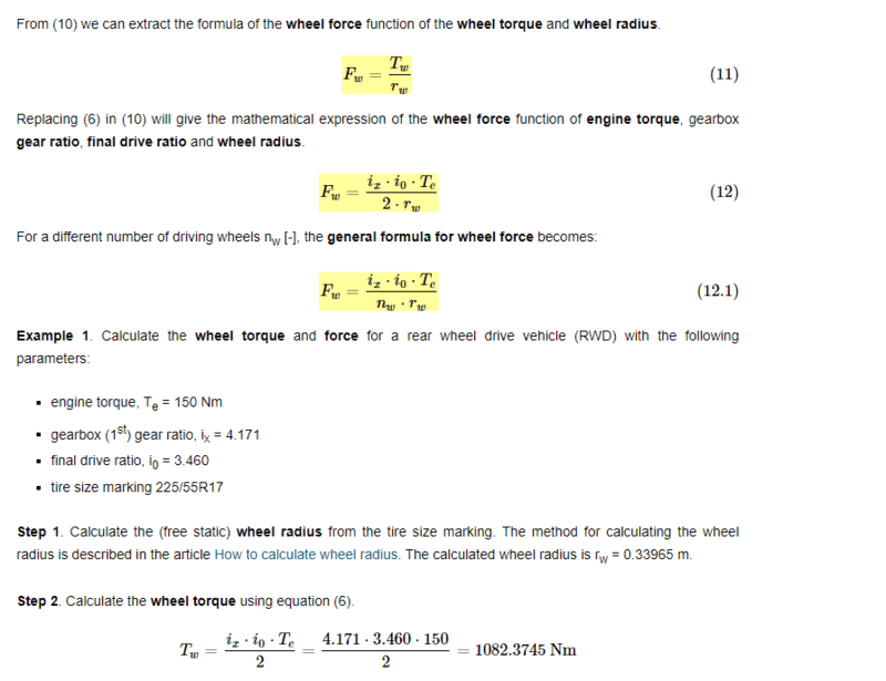

To be able to solve this problem, I found this.
nw stands for the number of wheels being driven which I'll discuss in the end.
If I understand right - total acceleration force does not depend on the number of wheels being driven and it breaks down into the number of wheels, so no matter if we have fwd or 4wd, the total force stays the same (of course such factors as friction, and grip are not considered here). In this case, we are not calculating each torque wheel separately but the total amount of torque transferred to the wheels and converted by the gearbox ratio. Hence we should get rid of the '2' which stands for the number of wheels in the denominator in the above equation
So is my thinking right -

from my first post, we should replace τ with the Tw from the previous equation so the final formula should look like this, am I right:

Andrewkirk, You said to 'multiply by the first gear ratio'.
Assuming we will be using at least two gears to accelerate from 0-100, shouldn't it be multiplied by the first two gears, not the first one only? I my above formula correct then?
kielbasa said:
It is unfortunate that the relevant equations have been presented as bit-mapped screen shots rather than as editable text or typeset ##\LaTeX##. I do not believe that the factor of 2 that is present in your final equation is proper.
Nor do I believe that the idea of a constant torque engine with no maximum RPM limit is particularly realistic. However, let us accept that idea and proceed with a step by step derivation. We are trying to arrive at the formula:$$a = \frac{i_0 \cdot i_x \cdot T_e}{R \cdot (M + 6m)}$$As I understand it, the numerator takes the engine torque multipled by the gearbox ratio to arrive at driveshaft torque. It then takes driveshaft torque times the torque multiplier at the differential to get torque at the wheel(s).
A classic rear wheel differential consists of a bevelled pinion gear mounted on the drive shaft mating at a 90 degree angle with a bevelled ring gear. The ring gear is mounted coaxial with the two axle shafts leading to the wheels. The axle shafts are joined to the ring gear with a torque sharing mechanism so that the sum of the torques at each wheel is equal to the torque the pinion gear applies on the ring gear. For normal straight-line driving, the torque is shared 50/50.
http://www.4x4abc.com/4WD101/img/difff.jpg said:
This means that the per-wheel torque is halved from ring gear torque. Which means that per-wheel traction force is halved as well. But we are after total force. So we will end up multiplying by the number of driven wheels. The result is a wash. Aside from the pinion gear/ring gear ratio, the presence of the differential has no net effect on the results of our calculation for total force or total acceleration.
We may as well pretend that we have one wheel drive. We have torque at the wheel given by ##i_0 \cdot i_x \cdot T_e##. Force at the wheel is torque divided by the wheel+tire radius ##R##. That accounts for the factor of R. So we have:$$F_\text{tot} = \frac{i_0 \cdot i_x \cdot T_e}{R}$$Effective vehicle mass is given by (for a somewhat reasonable assumption about wheel+tire mass distribution) ##M+4\cdot m \cdot 1.5##. Obviously, this simplifies to ##M+6m##.
The ##4m## is for the total mass of the four wheels. The multiplier of 1.5 is because the wheels are rolling weight. The total kinetic+rotational energy per unit mass goes as ##\frac{3}{4}mv^2## instead of ##\frac{1}{2}mv^2## as long as the mass distribution is like a uniform disc of radius R and we are rolling without slipping. That's the multiplier of 1.5
##F=ma## so ##a = \frac{F}{m}##. We've already decided that the effective mass is ##M+6m## and that the total force is equal to ##\frac{i_0 \cdot i_x \cdot T_e}{R}## so we put it all together and get$$a = \frac{i_0 \cdot i_x \cdot T_e}{R \cdot (M + 6m)}$$
Note that if you measure total vehicle weight ##M## by weighing the vehicle with the wheels on then you've already counted ##4m## as part of ##M##. In that case, the effective vehicle mass is ##M+2m## instead.
You will use the first gear ratio until you reach a speed where the engine reaches red line or a more optimal shift point.
Then you will use the second gear ratio instead. Until the engine reaches red line again or an appropriate shift point into a third gear is reached.
