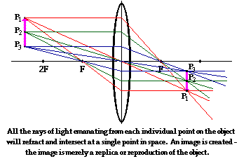

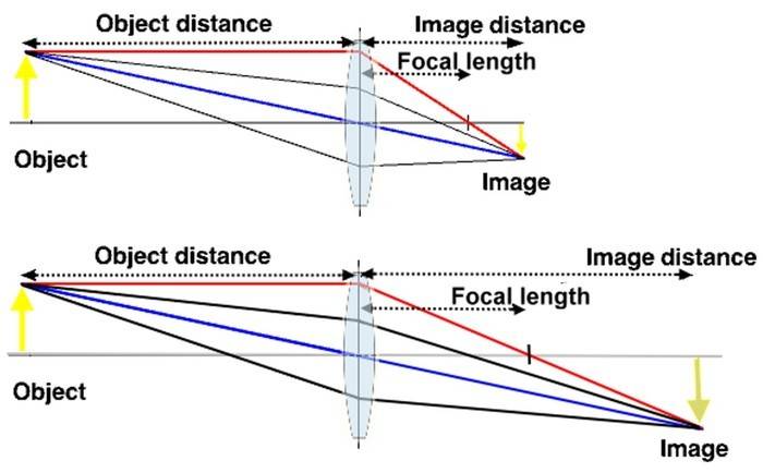

Think of a "focal plane" instead of a "focal point". The image of whatever you are looking at is focused along a 2d plane known as the focal plane. The image formed at the focal plane of a lens with a short focal length is smaller than the image formed by a lens with a longer focal length. See the following images:
Note how the light from each point on the arrow is focused to a different point at the focal plane. While this picture only shows 3 points, there are actually an infinite number of them in every image. The light a the focal plane is the combined light from every point. In the next picture, the light rays are emanating from P1 in the above image. The light rays from P2 and P3 are not shown.
See how the shorter focal length lens at the top forms a smaller image than the longer focal length lens at the bottom? If we imagine the light from P2 and P3 being placed in this image, you can see that the points are spread further out in the bottom image. Since every image is composed of an infinite number of points, spreading them out means that we are also spreading the light out and the image formed is dimmer. The total amount of light is gathered by the lens and deposited at the focal plane for both cases. The only difference is that the amount of light deposited per unit of surface area is different, being higher for the top case and lower for the bottom case.

So, to re-iterate and summarize (correct me if I'm wrong)
When focusing the light onto the paper, an image of the sun is formed. This image changes in size as the focal length does, with a longer focal length producing a larger image, in accordance with the laws of refraction for convex lens.
However, no matter how big or small the image is, the amount of light energy the image has is the same. This means that a smaller image is better, because it has the same amount of energy, but over a smaller area, leading to an easier scorch.
Exactly.
The sun is so far away that the focal length of the lens doesn't really matter. The demagnification is essentially infinite and the size of the focused image has more to do with imperfections in the optics (especially for a crude lens such as a jar) than the focal length. My guess is that a longer focal length will give a better focused spot even though the demagnification is less pronounced (closer to 1), because I think the imperfections will be less important. I wouldn't be surprised either way.
