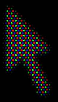

The phosphor dots were deposited photographically. The shadow mask was put in place and removed several times so that light from a source would hit only the desired spots on the photo resist on the tube face. Then the phosphor dots (each colour at a time) were deposited in (hopefully) the same places that the appropriate electron beam would hit it. Three light sources were used and adjusted to the same position as the virtual image of the electron beam sources.
The shadow mask tube was a great demonstration of just how much the manufacturers 'needed' to sell receivers and the lengths they were prepared to go to get Colour TV out to the public. Big business! As soon as Sony came up with the PIL tube( Edit ; I think it was called Trinitron and was earlier than PIL,) the whole problem of colour purity and convergence became much easier. Double whammy; the old shadow mask sets were so rubbishy that people went out and bought better ones, as soon as they were available. Then the public went wild about flat screen etc. etc... Home TV now mimics 1950s SciFi.

@sophiecentaur so you did describe the way in which color CRT's were built back in the day?
I guess it was easier to build the black n white screens where one would only have to apply phosphor to the screen and that's it, no dots no etching etc.

@tech99 a black n white screen yes but i was referring to a color screen
