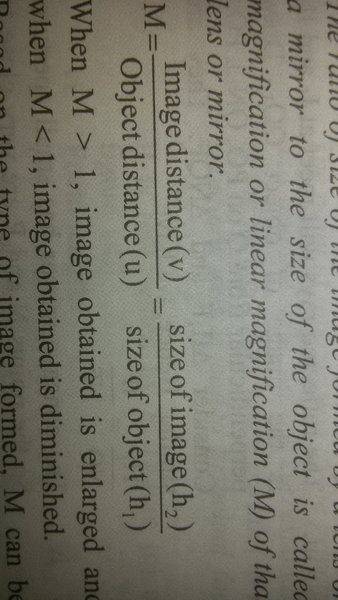

I needed help to undestand some concepts in Ray Optics for my assignment. The topics which U am concerned are: Part 1: Mirror Equation, Refraction at singly curved surface, lens maker's equation, combination of thin lenses in contact.
Part 2: Magnification Power of simple Microscope, Compound Microscope and Astronomical Telescopes.
First of all please explain me the sign convention. I don't need what it is, but how it works. Yoy apply it to derive fornulae, then again apply it in numericals to solve problems. How does that work? But I have failed to understand sign convention in the Part 2 topics. I mean in the solved problems, sigb convention is used and not used at random. How is that to be done? I have uploaded an image of a formula, I know its correcr for lenses, but tell me if I should put a negative sign on left side or right side to make it correct for mirrors. Thank you.
Attached.
I tried solving questions and I guess that for MP sign convention should not be used for solving numericals. But why?[/B]

There are different sign conventions in use. It does not matter which you choose, so long as you are consistent.
The one I use is 'Real is Positive' (It may have other names, but that's how I learned it.) In that, real objects and images have ositive distances from the lens, virtual objects and images have negative distances from the lens. Converging lenses form real images of objects at infinity, so have positive focal length. Diverging lenses form virtual images of an object at infinity, so have negative focal lengths.
For magnification ditances on one side of the optical axis are positive (usually up) and on the other side (down) are negative.
If the magnification is negative, that means the image is inverted.
But if you attach signs to magnification, the comment in your upload file should be talking about the magnitude of M (|M|) being greater or less than 1. If magnification turned out to be -2 say, the image would be enlarged even though M <1.
The one I use is left side of mirror lens is negative right is positive. Above the principle axis positive below is negative. Acc to that I talked about negative sign in Linear Magnification formula, but for mirrors only. For lens the formula should be correct. And yes the comment is about magnitude of M. Thank you for your input. What about using sign convention in numerical for Mag Power of simple and compound microscope? It really confuses me. Thank you.
