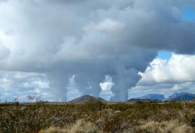

Water evaporated from Palo Verde 's cooling towers, courtesy this guy: http://skywalker.cochise.edu/wellerr/month-photo/january2011.htm
That looks to be a very humid day in the desert - look how low are the cloud bottoms.
