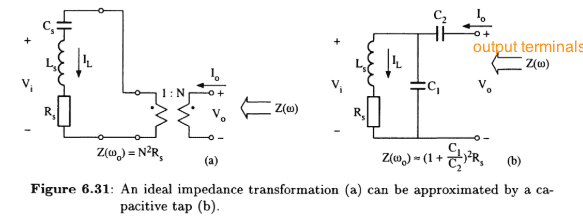

In diagram (b), imagine that the generator is on the "output" (RH) side, with a high resistance. Half close your eyes and you will see that C2 and C1 form a potential divider. So across C1 we have a lower resistance than the generator. There are no losses because C is reactive. Of course, by using a capacitive divider we have introduced unwanted reactance in series with our new load (R1). This is removed by L in series.
There are several ways of looking at the circuit so I will try again if you don't quite get it.
Thanks for your reply.. generally a capacitive divider is just like a resistive voltage divider which also transforms the voltage i.e decrease voltage but at a specific frequency...same would have been the case here, but i am not sure about the phrase which says “increase in output voltage in accordance with the ratio of the capacitors..
I am also thinking like this that the voltage in two parrallel branches (L1 and C1) are the same...and if the voltages in both two branches are same ..then from where comes the notion that “increase in externally required voltage” comes in.
Another thing..as C1 will have lower resistance then more current should flow through it hence reducing the voltage in the C1 branch further reducing the output resistance ..but this does not support the text anyhow..

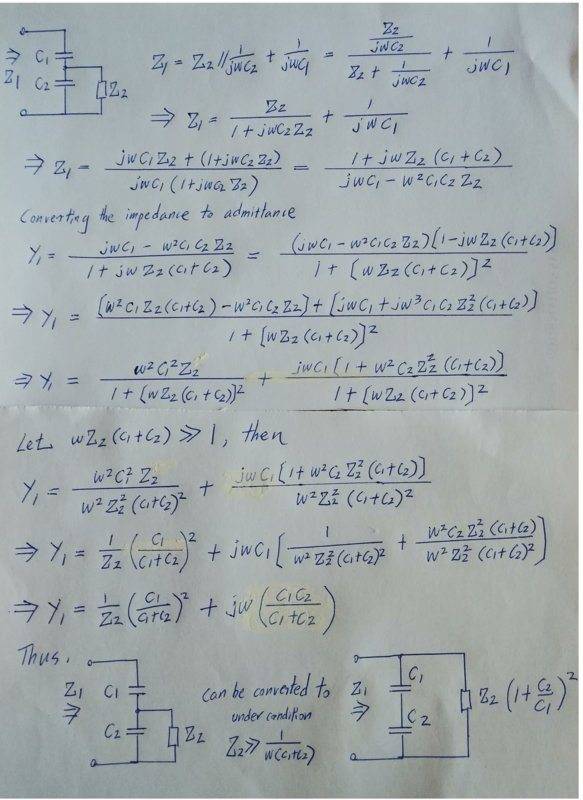

I think that sometimes it's inevitable to involve some mathematics in order to get a clearer picture of the relevant content in engineering analysis, even though I don't like the long and tedious algebraic calculations myself.
I tried to analyze the most basic and simple tapped capacitor impedance transformer as shown below.
Likes tech99 and brainbaby

Thank you alan123hk. I think this is a step down transformer, so you need an L to obtain an overall step up and also to cancel the capacitive reactance introduced by the network.
Yes, that is an incomplete circuit diagram of the tap capacitor impedance transformer, which requires an L to complete the parallel resonant circuit.
After adding an L, the three elements (L,C,R) in the parallel resonant circuit are : -
1. inductor L
2 capacitor C=(C1*C2)/(C1+C2)
3 Resistor R=Z2*(1+C2/C1)^2 (In this case, let Z2 be a pure resistor)
I believe that a set of design formulas can be easily derived based on this three elements simple parallel resonant circuit, which is expected to be similar to that shown on the link above.
Interestingly, it seems that even though Z2 contains resistive and reactive components, we may still get the equivalent circuit, although the equivalent circuit would become more complicated, but I am still uncertain about that.

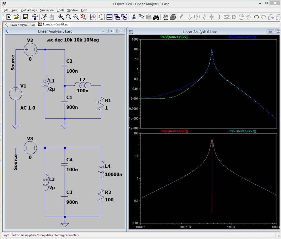

The reactive part of Z2 is absorbed into C2.
It is true that the reactive part of Z2 can be absorbed by C2 .
On the other hand, I am just curious that if Z2 contains resistive and reactive components, is the formula Z1=Z2 *(1+ C2/C1)^2 still applicable?
Therefore, I tried to simulate one example as shown below.
Based on the simulation results, the conversion still seems to be valid for frequency ranges above 300 kHz.

Lets analyse fig 6.31 again...We will talk in terms of of law of conservation of power.
As law of conservation of power states that the algebraic sum of power across each component in a circuit is zero.For algebraic sum to be constant requires the individual power of all the component should be analogous to any other component , for eg. if the magnitude of the power of an individual component increase to a certain amount then there should be compensatory change by the same amount in power of another component and so forth...
So in figure 6.31a) the sum total of Power of Cs, Ls, Rs and Mutual coil is equal to constant or zero. IL in 6.31 a) is constant for two reasons:-
1. As there is no parallel path where the current IL can divide.
2.To maintain the power constant.---->Question- For power to be constant why constant current is preferred, as power depend upon other factors such as voltage and resistance as well.??
Now in second figure this current IL divides among two capacitors C1 and C2.. thus now IL decreases. Hence in 6.31b) IL changes along with output current Io.
1. Same we will take again for 6.31 a) since IL is constant in this case Vi is not changing but in 6.31 b) IL changes which further changes Vi. Now according to my bold points if Vi decreases then it should induce an equal and opposite change in any other part of the circuit to conserve the quantity which is power in this case, hence Vo (output voltage increases to an amount which is equal to the amount by which Vi decreases.
Now increase in Vo and decrease in Io can be thought of as increase in impedance ..
Hence we can say tapped capacitor increases the impedance .....BUT....
again this hypothesis brings another confusion and that is:-
2. If Vi decreases which increase Vo by same amount, should be true for the current (Io) case as well. The decrease in IL due to the capacitors, should bring an equal and opposite change in the current quantity as well so to compensate the decrease in IL the output current Io in the circuit should increase..but if Io increases then impedance should decrease which is against my conclusion 1.
Result- Both conclusion doesn't seemed to be coherent...
Please comment!
