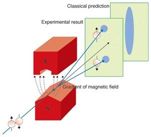

How does the thermal interpretation explain Stern-Gerlach?
In summary, the thermal interpretation views the measurement of a Hermitian quantity as giving an uncertain value approximating the q-expectation, rather than an exact revelation of an eigenvalue. Applied to the Stern-Gerlach experiment, the observed result is seen as an uncertain measurement of the q-expectation of the spin-x operator, which is zero for a beam of spin-z up electrons passing through a Stern-Gerlach device oriented in the x direction. However, this interpretation is inconsistent with the classical prediction of a normal distribution for a quantity with a q-expectation of zero. In the thermal interpretation, the measurement device is always treated as a quantum device, and the beam is represented as a quantum field with a sharp number
47,459
23,741
I am posting this question separately from the ongoing thermal interpretation thread started by @A. Neumaier since it is a question about a specific experiment and how that interpretation explains it.
The experiment is the Stern-Gerlach experiment. For concreteness, I will specify that we are considering a beam consisting of a large number of electrons all prepared with spin-z up. The beam then passes through a Stern-Gerlach device oriented in the x direction. Experimentally we know that the beam splits in two: there is a left beam and a right beam (corresponding to the two possible spin-x eigenstates), with a low intensity region in the middle.
Part III of the series of papers by @A. Neumaier on the thermal interpretation deals with measurement:
https://arnold-neumaier.at/ms/foundIII.pdf
On p. 4 of this paper, it is stated:
[T]he measurement of a Hermitian quantity ##A## is regarded as giving an uncertain value approximating the q-expectation ##\langle A \rangle## rather than (as tradition wanted to have it) as an exact revelation of an eigenvalue of ##A##.
Applying this to the Stern-Gerlach experiment, we would view the observed result as an uncertain measurement of the q-expectation of the spin-x operator as applied to the electrons in the beam. This q-expectation is easily seen to be zero. For this case we can use the usual formalism of state vectors and matrix operators: in the spin-z basis, the state of the beam after preparation is the vector ##\psi = \begin{bmatrix} 1 \\ 0 \end{bmatrix}##, the spin-x operator ##\sigma_x = \begin{bmatrix} 0 & 1 \\ 1 & 0 \end{bmatrix}## flips the state to ##\begin{bmatrix} 0 \\ 1 \end{bmatrix}##, and the expectation ##\langle \psi \vert \sigma_x \vert \psi \rangle## is therefore the inner product of ##\psi = \begin{bmatrix} 1 \\ 0 \end{bmatrix}## and ##\begin{bmatrix} 0 \\ 1 \end{bmatrix}##, which is ##0##.
So the thermal interpretation is telling us to interpret the experimental result, of a left beam and a right beam with low intensity in between, as an uncertain measurement of the q-expectation of ##0##, which would correspond to a point in the center. But this does not seem right: it seems like an uncertain measurement of a quantity whose q-expectation is ##0## would be a normal distribution about the value ##0##, i.e., an intensity peak in the center and decreasing to the left and right. (This is, of course, the classical EM prediction which was famously falsified by Stern and Gerlach.) So my question is, in the light of this seeming inconsistency, how does the thermal interpretation explain the Stern-Gerlach experiment?

PeterDonis said:
So the thermal interpretation is telling us to interpret the experimental result, of a left beam and a right beam with low intensity in between, as an uncertain measurement of the q-expectation of 000, which would correspond to a point in the center. But this does not seem right: it seems like an uncertain measurement of a quantity whose q-expectation is 000 would be a normal distribution about the value 000, i.e., an intensity peak in the center and decreasing to the left and right.
It is what one gets when one wants to measure a q-expectation ##\langle \sigma_3\rangle \in[-1,1]## by experiments that, by their very spatial QFT analysis, allow only approximate measurements at the end of the beams, i.e, possible values left spot (-1) or right spot (+1). This is an instance of the quantum bucket intuition.
The uncertainty of a single measurement is predicted to be ##\sigma=1##, and indeed in your case (true value 0), the error of both approximate measurement results ##\pm 1## is ##1##. To improve the accuracy one needs to average over multiple measurement, and gets better results that converge to the true value 0 as the sample size gets arbitrarily large.

Post #135 explained the Stern-Gerlach experiment as follows:
A. Neumaier said:
In the thermal interpretation, the Ag field is concentrated along the beam emanating from the source, with a directional mass current. The beam is split by the magnetic field into two beams, and the amount of silver on the screen at the end measures the integrated beam intensity, the total transported mass. This is in complete analogy to the qubit treated in the above link. Particles need not be invoked.
Thus what is measured by a spot is the intensity of the silver flow into the spot, not the spin of single electrons. The original Stern-Gerlach paper (and the early discussion about it) indeed talked about Richtungsquantelung (quantization of directions) and not of spin measurement. The fact that two beams appear is a consequence of the spin of the electron field, but has nothing per se to do with measuring the spin state. The latter is defined only for single electrons!
Things are different if you want to consider the Stern-Gerlach experiment as a spin measurement experiment. In this case one must - like every introductory text - treat the silver source as producing a large ensemble of single atoms and the quantum bucket becomes relevant. Each single atom deposited is one bucket event emptying the inflowing silver field. It approximates the true value 0 by either ##+1## or ##-1##, the only possible bucket results (nowhere else is positive field density). This holds for every single atom, and hence for all silver arriving in the two spots.
PeterDonis said:
The quantum bucket intuition doesn't help here because the flow is large, so I should be able to measure it accurately; I shouldn't have to accept the inherent uncertainty of taking a single bucketful at random intervals. So by your own description, for the case of a high intensity beam being fired at the apparatus, I shouldn't get two spots any more; I should get the classically predicted result (normal distribution about the center, value 0). But I don't.
Taking the single buckets as measurement results each time in a binary measurement of the true (theoretically predicted) uncertain number ##0\pm 1## consistent with the measurement error of 1 in each case. This is completely independent of the flow rate!
To improve on the resolution one must consider a different operator, namely the mean spin ##s=N^{-1}(s_1+\ldots+s_N)##, where ##s_k## is the ##S_z## of the ##k##th silver atom in the ensemble measured. This mean spin operator has an associated (theoretically predicted) uncertain value of ##0\pm N^{-1/2}##, which is approximately measured by the mean of the bucket results. This mean is for large ##N## Gaussian distributed with zero mean and standard deviation ##N^{-1/2}##, matching the prediction.
That's fine, but it doesn't address my question. The expectation value of "intensity of silver flow" is still zero--it says the silver should be flowing into the center, not into two separated spots. So why is it flowing into two separated spots? And to be clear, I am not asking why in terms of how the math gives that result; I already know that. I'm asking in terms of interpretation: how does the thermal interpretation, as an interpretation, explain how an uncertain measurement of silver flow into the center (since that's the q-expectation, and therefore that's what the thermal interpretation claims is "real") shows up as two separated spots?
Likes Demystifier
No. You are conflating it with the q-expectation of the spin of single particles, which is zero!
The intensity of silver flow is the function of the position on the screen defined by the q-expectation of the incident current integrated over a spot centered at this position. No other expectations are involved.
Given the setup, the intensity is positive at the two spots predicted by the mathematics of the theory, and zero elsewhere. This is why the silver flows into these two spots and nowhere else.
The only q-expectation that matters is the intensity of silver flow as a function of screen position.
It is zero at the center, so nothing flows there.
Ok, then I guess I am confused about the math. :wink: Mathematically, how is the q-expectation of silver flow calculated? (Since obviously the math I gave in the OP is not the right math for this.)
See post #282 of the other thread, except that the electric current is replaced by a silver current (which means that the formula defining it is a complicated multibody current). And of course for the silver deposited you need to also integrate over the time of the experiment.
