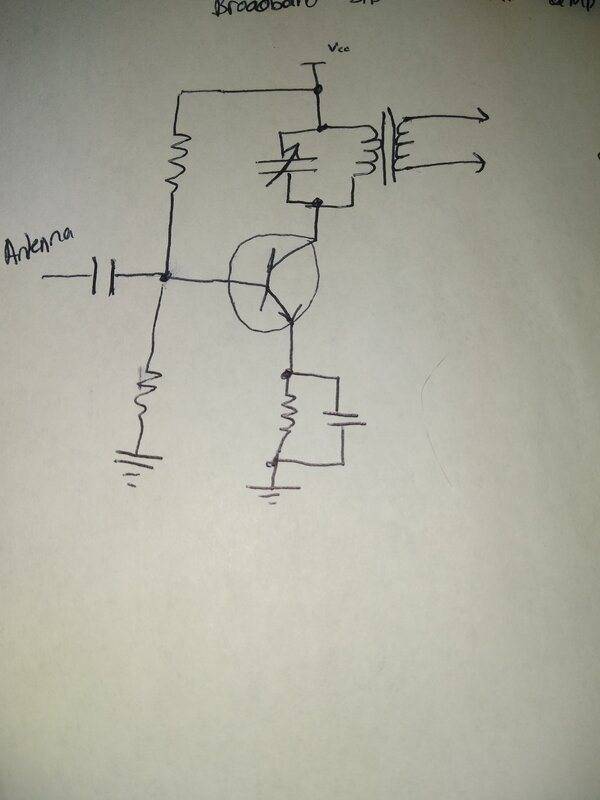

I am trying to create a receiver for a personal project I am working on. This is the RF amplifier that I was given by a book I am following. How does this circuit work? Usually for a BJT amplifier I find the DC bias point and then use the small signal model after I bias the circuit? I understand that if I wanted to find the DC bias point then all the capacitors would become open but what would happen to that transformer? Will it just become an open like an inductor? Am I not supposed to do DC biasing for this circuit? I would also appreciate any sources on RF amplifiers. I want to be able to do the actual circuit analysis of them, the book I am reading does not analyze them but instead just gives me the circuits required.
Boltzman Oscillation said:
Homework Statement:: How does the transformer work in this circuit?
Relevant Equations:: KVL, KCL, BJT equations, etc.
Looks like it is using a voltage divider dc bias. It is formed by Vcc-2 resistors connected to base terminal -ground.
Antenna feeds the input signal through the two coupling capacitors. The capacitors "block" dc component in the input.

When we look at just the DC signal of the circuit then the capacitor in parallel with the transformer will become an open. What happens to the transformer?

I don't know RF amplifiers in detail, but the LC loop looks like a tank circuit tuned to a certain frequency fcertain. This tank circuit will pick only the component of input signal with frequency fcertain.
In presence of only dc bias, I don't think the capacitor will be open circuited. The tank circuit will still resonate at its natural frequency.

Yup, @cnh1995 got it right. The variable capacitor in parallel with the inductor is adjusted to resonant at the frequency of the radio station you want to receive.
Since it is a parallel resonant circuit, it acts as a high impedance Collector load at its resonant frequency, and as a lower impedance load at other frequencies. The end result is a signal at the resonant frequency is amplified more than other frequencies.
Now to get the amplified signal to the next stage in the receiver you have a couple choices:
  • you could use capacitor coupling by connecting a small capacitor from that Collector to the Base of the next stage
  • you could wrap a few turns of wire around the inductor to make a transformer and connect that secondary winding to the next stage
A couple of advantages of using the transformer approach is it can be a little more effecient in signal transfer by better matching the input impedance of the next stage, and if you choose you can also tune the secondary winding to increase the selectivity (rejection of nearby frequencies.) (Also you can make transformers at home, capacitors are a little tougher)
In this case, for DC biasing you can usually treat the Collector inductor as a short circuit, and bias for perhaps 1mA Collector current, actual value is not critical.
Let us know how it turns out!

So when the amplifier is just powered on without antenna input, does the LC circuit act as a damped oscillator, which settles down with capacitor shorted out by the inductor?

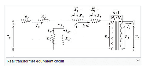

So the primary winding of the transformer can be treated as an inductor?
For dc, yes.
It's better to keep the full model of the transformer in mind, IMO. The load impedance is transformed back to appear in parallel with the magnetizing inductance Lm of the primary winding, with the leakage inductance Lk in series with all of that. Depending on the application, the full model (including the capacitances) may be important. If the transformer output is lightly loaded and the ration of Lm/Lk is high, you can just treat it as an inductor.

Well, I suppose you could say that. If you replace "damped oscillator" with "damped tuned circuit" I think the description would be a bit more understandable.
edit:
For dc, yes.
And for AC as an simple inductor IF the secondary is lightly loaded, or loosely coupled to the primary; as @berkeman pointed out.

In this case the secondary has no load, and thus the primary is treated as an inductor.
What good is an input amp with no output load? One hand clapping? :wink:

Eh I am learning the different stages of a receiver and an RF amplifier is the first stage so I just want to test it out first. Will LTSpice be able to simulate this? I am just trying to make sure i understand the concept and not blow up a component in the process. The ultimate goal is to make a device that tracks the location of an RF signal source.
Sure, although it may not appreciate the open circuit at the output of the coupling transformer. Start with a 1MEG resistor on the output coil to keep the simulation from throwing an error.
In regard to the question of whether the tank circuit will self oscillate, the answer is no. To experience sustained oscillation an electronic circuit has to have a feedback from the output (collector) to the input (base) in the proper phase. The output signal is 180 degrees out of phase from the input so feedback applied directly would suppress oscillations, negative feedback. Audio and RF amplifier designs frequently employ negative feedback to suppress any tendency for an amplifier circuit design to oscillate. This circuit employs no feedback. If it employed positive feedback (a sampling of the output signal is directed in phase to the input) you have an oscillator. The ARRL has some excellent literature on rf receiver, amplifier and transmitter circuit design of a practical nature. Texts should be available in your library.

It would help if you labelled the components in the diagram
The purpose of the capacitor across the emitter resistance is to increase the ac, or signal frequency, gain. Its time constant, T = CR, is set to be much longer than the signal frequency.
The voltage divider sets the base voltage to Vbe * R2/(R1+R2) by assuming base current is negligible (ie Ic/Ib gain is high).
The emitter resistance sets the emitter current, and hence the collector current, as Ie = (Vb - junction voltage) / Remitter.
If the emitter capacitor is omitted, and the input rises by 1V, the emitter and collector current increases by 1V divided by R emitter. To get a high gain you need R emitter to be small but you cannot because of the bias requirement.
So, the capacitor is placed across the emitter resistance in order to hold the emitter voltage steady (or, if you prefer, to reduce the ac impedance at signal frequency to a low value). A 1V increase in base voltage at signal frequency will now create a huge increase in collector current and, as the change in output voltage is equal to the collector load times the change in collector current, the voltage gain is high.

This is an amplifier having a tuned transformer output. A load resistor of some form (maybe the input of another stage) is connected across the right hand winding, which is the secondary, and creates a different value of resistance across the primary as a consequence of the turns ratio. At the resonant frequency, the transistor sees just this resistance, because the parallel LC circuit has very high impedance. At frequencies away from resonance the LC circuit has lower impedance and shunts current away from the resistive load, giving filter action. The sharpness of the filter is decided by the ratio of the resistance divided by the reactance of either L or C (they are the same) at the resonant frequency. This ratio is Q, the Quality Factor of the resonant circuit. The bandwidth is equal to the resonant frequency divided by Q (measured to the half power points).
In calculating gain, the transistor is working into the resistance coupled into the primary. You can often consider the transformer to be perfect because leakage inductance is removed by the resonant action - it just shifts the resonant frequency a bit.
Regarding DC operating conditions, the Cs are open circuits, but the L provides very low DC resistance, so the collector is at supply voltage but has a resistive load as described above.
